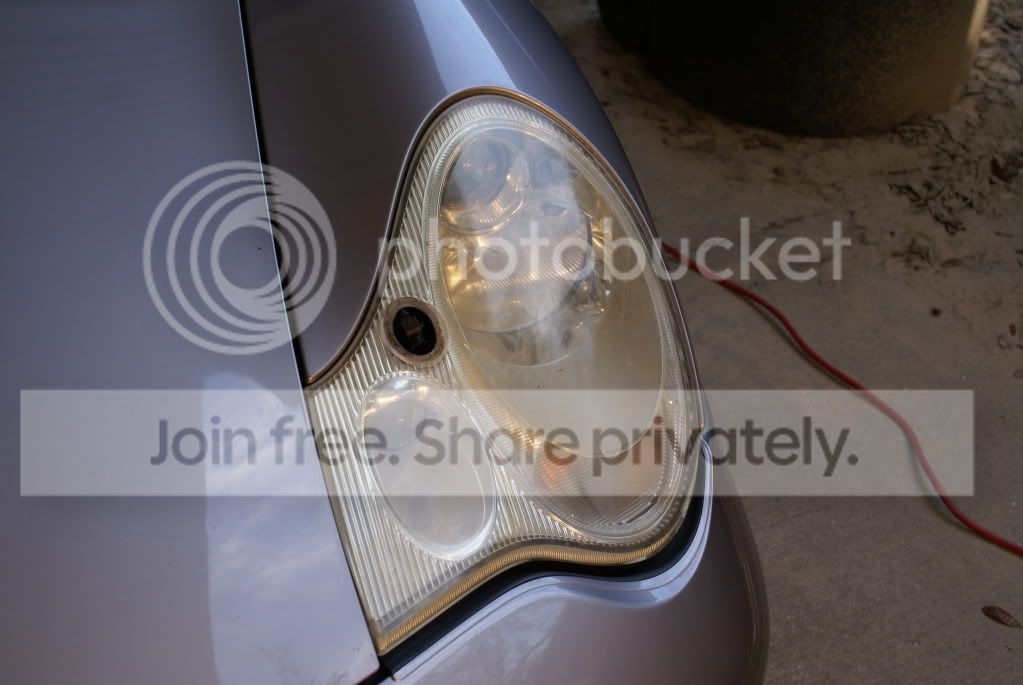

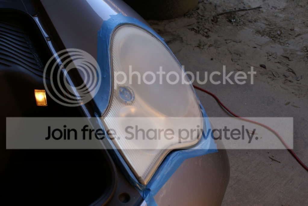

So I had the car in the garage this weekend looking at the brakes, and while it was there I decided to clean up the headlights. I live in Florida, drive the car daily and typically park outside. The sun and UV have wreaked havoc on the headlights so I decided it was time to bring them back. I took a ton of pics and started to write up a tutorial to use as an alternative to the "headlight restoration" kits at the autoparts store. I have never used one of the kits, but am quite happy with my results doing things the old fashioned way.
The whole job took about 3 hours start to finish with the majority of the time spent taping up around the headlights. I am sure pulling the headlights and sanding them down on a bench would produce better results and may actually take less time. I decided not to post a how to because mistakes with a D/A sander or lack of attention when wet sanding could do more harm than good, but if you have questions let me know and I am happy to provide more details.
Anyways.... on to some pictures.
This is how the headlights looked before getting started (unacceptable)
I taped everything up and sanded the lights with a dual action sander:

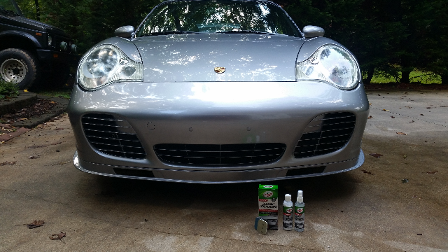

This is how mine were.
