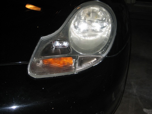

I did mine a few months ago as well. I actually started with a light scuff sand with my D/A sander. I VERY lightly went over the lights with 220, 400 & 600 grit paper. Then wet sanded by hand with 800, 1500, 2000 & 3000 grit. Finished with a high speed buffing wheel and some polishing compound. The lights looked good as new when complete.
Just take your time and be gentle if you decide to use a D/A. In hindsight I probably could have started with 400 or 600 grit, but I was not aggressive, so I don't think I took off much more plastic than I needed to. If you have never wet sanded before, just use gentle pressure the surface tension of the water pulling the paper to the lights is almost enough, and be sure to rinse the paper and change the water in your bucket often.
I left the lights on and just taped everything up around the lights, but if I were doing it again I would pull them off the car for sure. It would make it a lot easier, and eliminate the possiblity of a painful (and expensive) mistake. In the picture the passenger light was completed, and I had just taped up the drivers side, so you can see what a difference there was.
