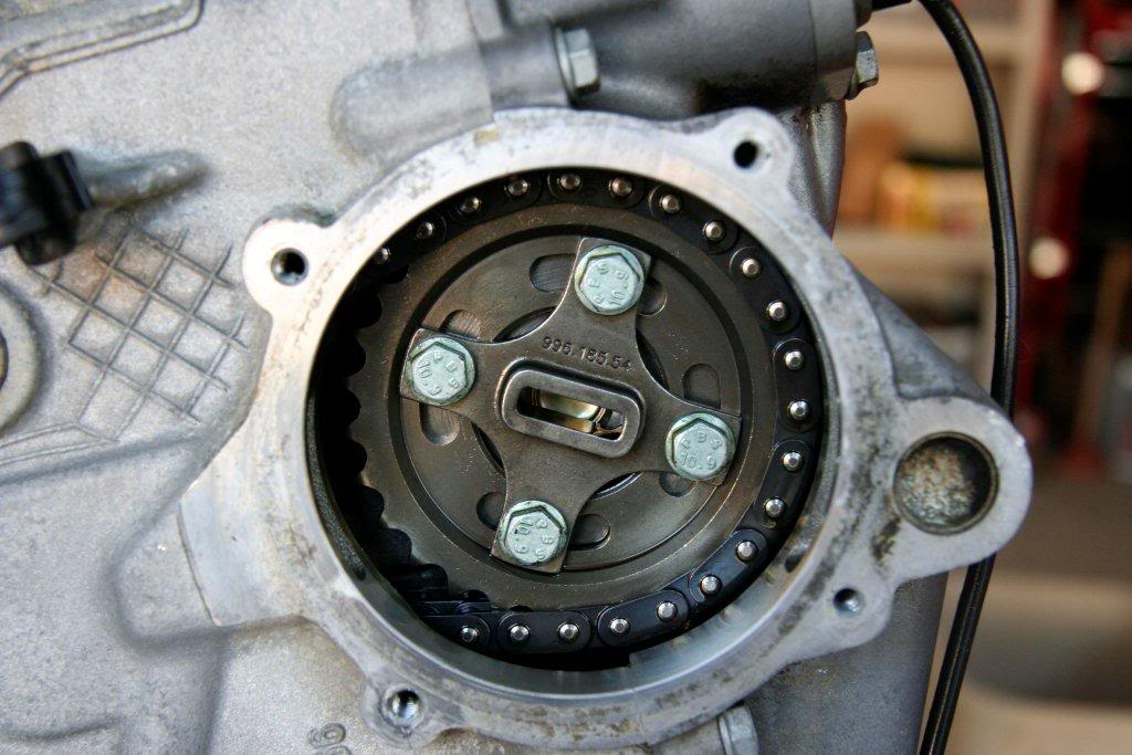

Going to work on it tonight. I'm guessing that bank 4-6 wasn't torqued to spec and I can guarantee there's no locktite on the cam bolts. Ouch! I hope I haven't been driving it with the camshaft sprocket loose.
Not my picture below... I'll see if I can get some good pics tonight.
