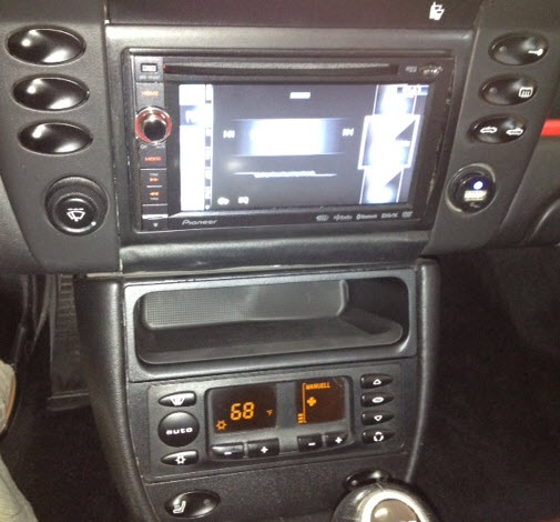

Added a Pioneer AVIC-930bt plus brand new speakers and had to go with a new amp since I had the MOST system. $2200 total inc installation. The amp and pre-amp are in the front.

Great news on the most(or lack thereof)! I DO in fact have door speakers so i'll look at crutchfield. my thoughts are that I'll also need the Loi kit for double din, i'll need to relocate my HVAC controls, and purchase the "upper" cubby hole. That and THEN get speakers so the head unit may take a back seat for now.

There are three or four connectors on the back of the HVAC control that have to be rerouted. Takes maybe half hour to an hour. You can scrape a few knuckles doing it as it is pretty tight behind the various controls.
