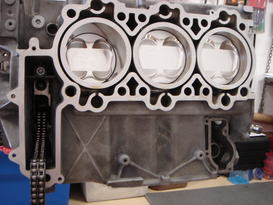

Does anyone know if the crank cases come as a matched pair? - i have managed to find a good used crank case cyl 4-6 but before i purcahse i need to know if i can bolt up to my existing cyl 1-3 half? -obviously after a clean and check for flatness/resurface.
i cant find any info on this. I wouldnt usually go down this route but time is if the essence to get this repaired and i cant wait 3-4 weeks for the machine work in the UK for a new liner.

Crankcases, like cylinder head & cam covers are machined together to be mates for life so it's not ideal. Porsche will not sell a cam cover without the head to go with it. I don't know if Porsche sells case halves seperatly but if they do that might be a good clue of your chance of finding a good mate. There is a good chance that several of your cylinders have excessive wear so it is better to resleeve all of them. You can add displacement too!
