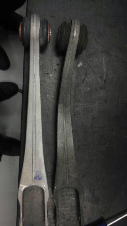

Just for closure on this, I had it aligned at Porsche. The problem they found was the following.
1. New tires that PO put on are crap (Nitto) and are slightly wider than spec at 235/40-18 not 225/40-18
2. Passenger Rear control arm was bent and needed replacing. See attached.
Rob
