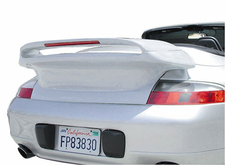

. if you want a new wing/decklid anyway then it makes more sense.
You want a rear deck lid like the 993 TT or like KVP. That lid seems to have much more room and I would hope better breathing.

I have seen a bigger lid on renntech or somewhere, but cost is a factor.
This would do it right and looks hot, IMO
http://www.gemballausa.com/996coupe_aero.asp
