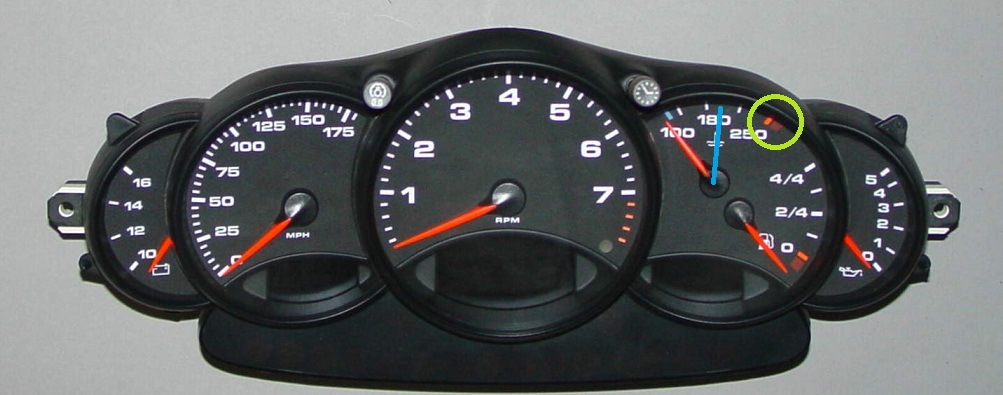

Here's a picture. (not my actual cluster)
Blue signifies my temperature while driving.
Green signifies where it blinks. (not steady)

thats where mine is pegged...takes a while to get there then stays there. but i dont get a blinking

Again, go to your manual. The illumination of that light has several different meanings. Once you've read the manual section you will know the 3 things to check.

Your gauge appears normal (~180*). I checked my owner's manual: If the coolant temperature is too high, the warning light comes on... If the coolant level is too low, the warning light comes on...In addition, this warning light flashes to indicate a fault in the engine compartment blower fan. I believe the latter is the culprit. Good luck.
