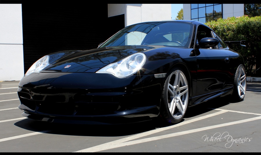

After reading dozens of threads and contacting several wheel vendors.
When it comes to 19" Wheels on a 99-01 911 NARROW BODY!
FRONT: 19x8.5 et45mm using 235/35/19 Tires.
REAR: 19x11 et52mm using 315/25/19 Tires.
If the car is lowered, rolling fenders is required.
