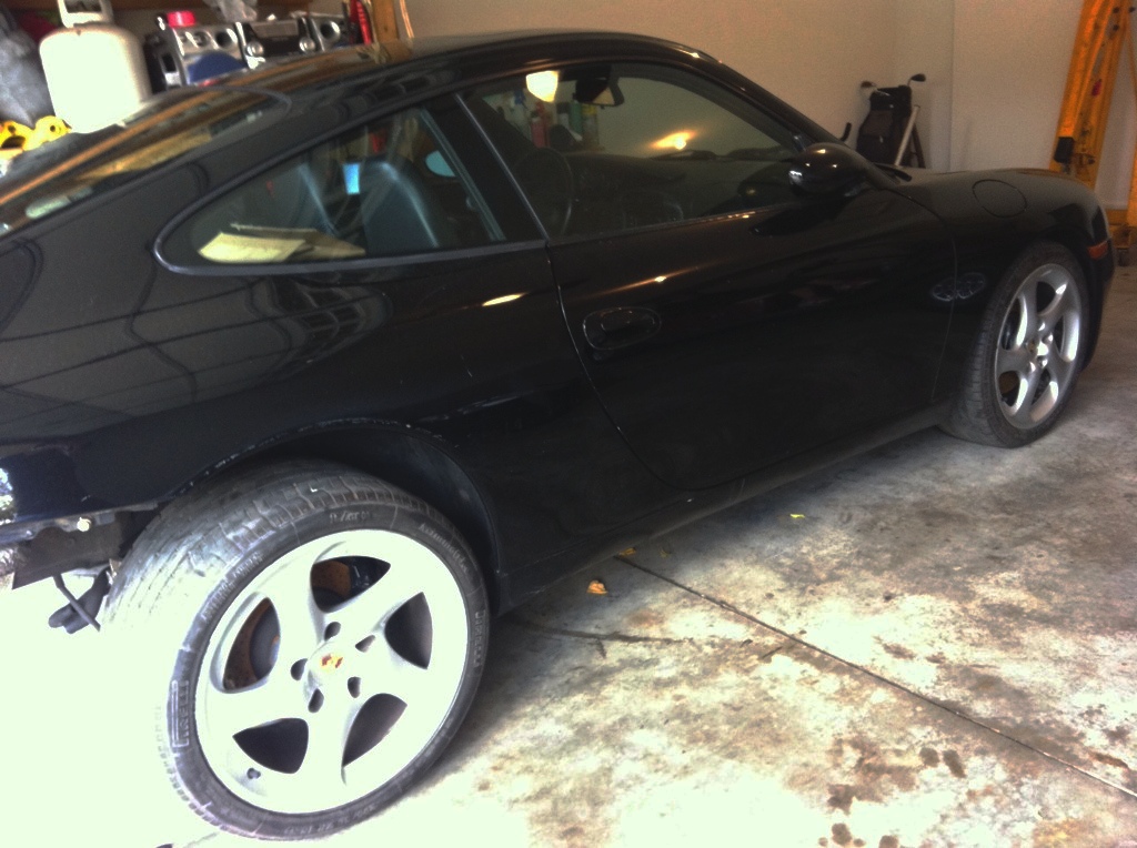

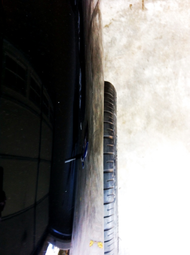

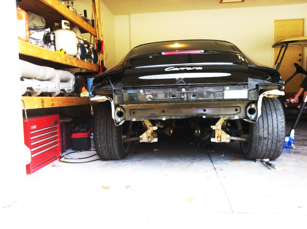

turbo wheels on my '99 NB (engine and trans are out, so the camber is off and wheel gap is massive).

WB wheel on right, it has a taller tire too (notice rake in car's stance):

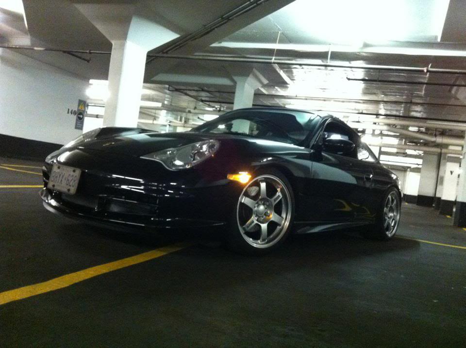

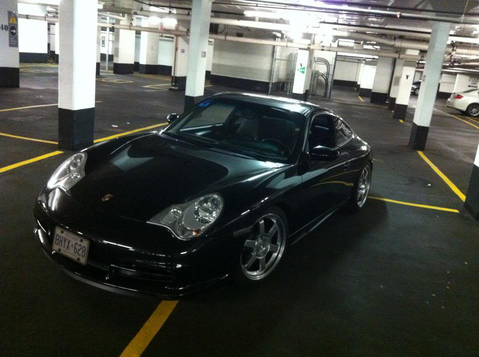

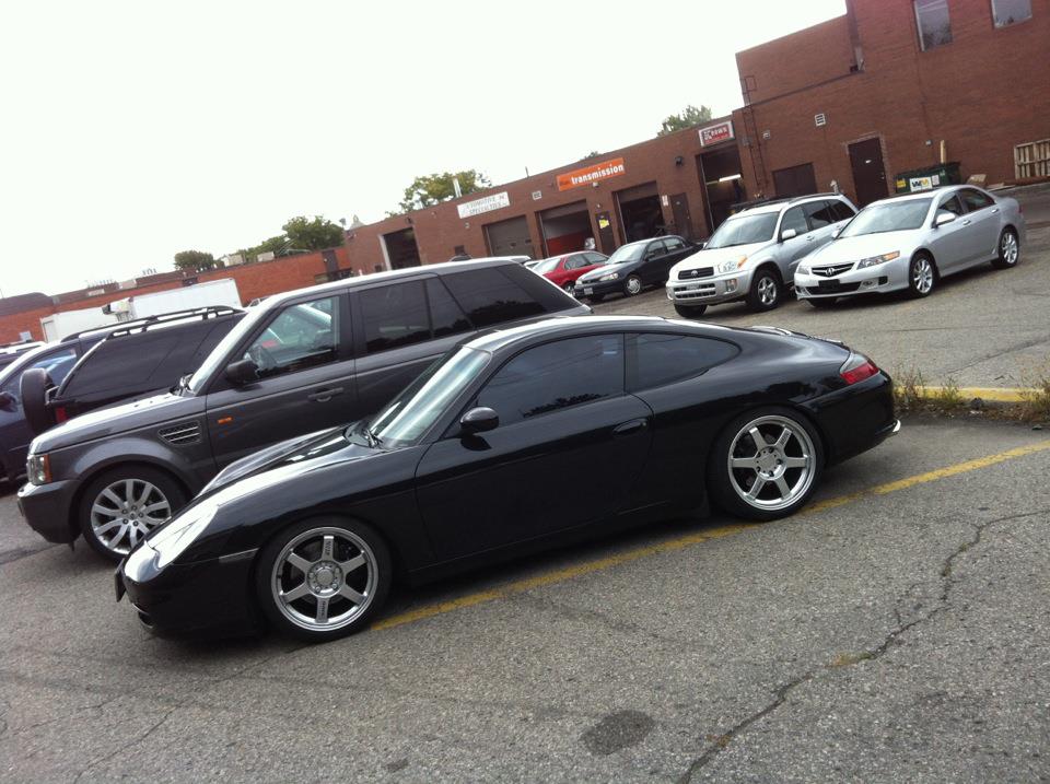

Mine is just a Carrera 2, Front tire size is 225/40/18 and Rear 285/30/18..... I thought is no way to be fit too, but it was just perfect come out to me.

Based on those pics, there is no way you're running 32mm offset front and 40mm offset rear.
Have you seen the poster above yours that had the shot of the Turbo Wheels? The stock Turbo wheels are 45mm for the rear so yours at supposed 40mm would stick out more. I just don't see that from the pics.
Well when car lower more and more negative camber. When my car raise up on hoist wheel stick out exactly like that turbo wheel..... But my set of TE37 are for turbo too but that's work on mine and I have no issue of rub in Mosport GP track canada.
