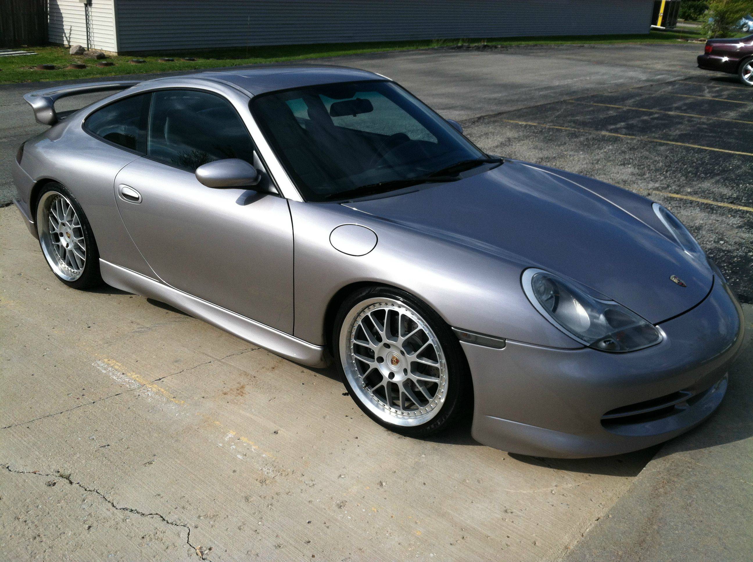

I bought a 2001 996 about 3 months ago. One week after I bought it I had to replace the clutch. Then about 3 weeks later I had to buy 4 new tires. Today I got news that I have cracks in the head that has been allowing oil into the cooling system and completely blasted my engine. I must have the crappiest Porsche in existence.
Any advice on the cheapest way (within reason) that I can get this car back on the road. I have been told 15k twice. There has to be a better way. Please help!

wow, very clean looking car. love the aero
