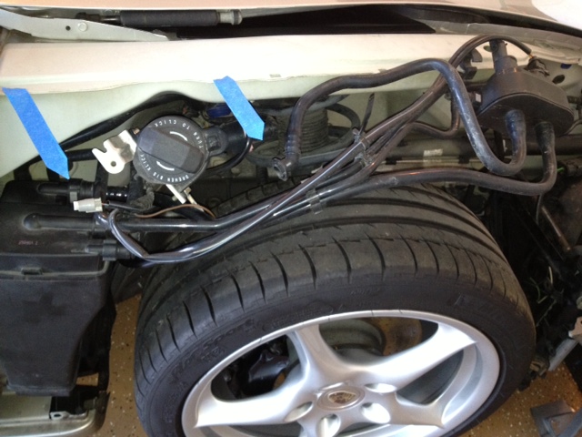

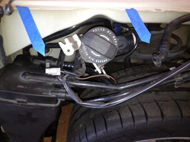

Not sure what component that is missing. Blue arrows point to a white electrical connection and a hose. Can someone please tell me what the missing component is. --- 04 C2 Cab- Passenger side front fender ---

connector is for the gas door solenoid lock. the open ended hose is the recirculating overfill gas hose that goes on the bottom part of the gas cap. If you ever overfilled your gas tank by mistake at the pump, you've probably seen it. that's where the gas goes...

Solved!
Much thanks Joel. I had no references as I purchased this car in this condition. Thanks again!
