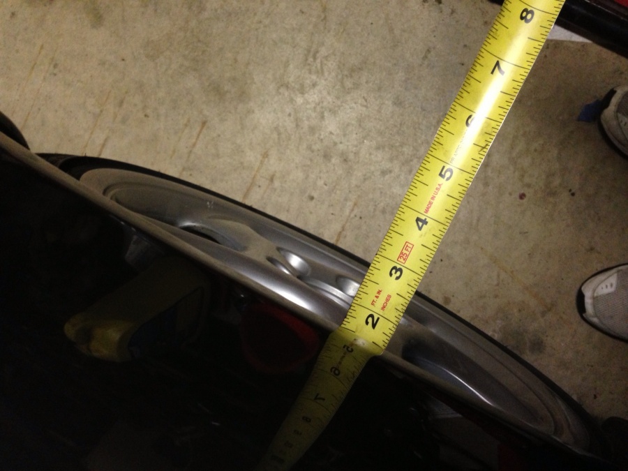

I did a sanity check after this post. The existing wheels are indeed inset quite a bit. I got out the tape measure and measured from the top of the wheel and a little over an inch seems just right.
H&R makes a 30mm kit that I ended up ordering. I'll post back when they arrive and are installed. If I goofed, I guess eBay or the FS forum will be getting a new set of 30mm spacers

Your picture shows the ruler at 1.5" to the outside of the wheel opening, is that to the edge of the tire? The 30mm spacers will move the tire out 1.181" so you will be very lose to the inner edge of the wheel well. Looking forward to see if this works.

It is actually against the wheel itself, but the 265's don't really stick out on a 10" wheel. If I have to dumb it down, H&R makes a 25mm kit as well.
