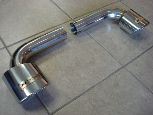

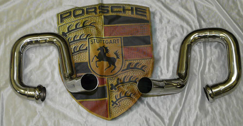

Well looking at these: http://www.maxspeed-motorsports.com/996mb.html
Or these:
The Maxspeed I use my own tips and the claim that since they're longer and have bends in them you don't loose much back pressure. Also since they are longer and not directly off the cats may not be as loud.
Thoughts??
