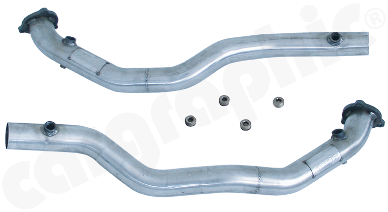

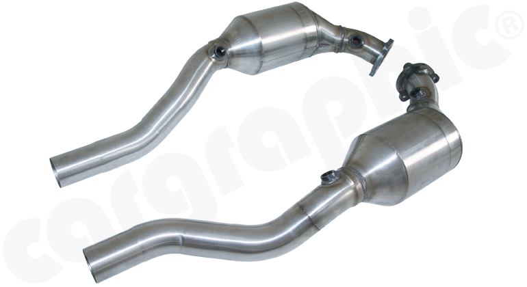

Stainless Steel Sport Catalyser Set Cross over version 2x Trimetal Ø130mm big volume 200 high flow HD Catalysers OBD2 compliant 7KW (10PS) more power and 10Nm additional Torque.
Stainless Steel Catalyser Replacement Pipe Set Without Catalysers ECU reprogramming required.
