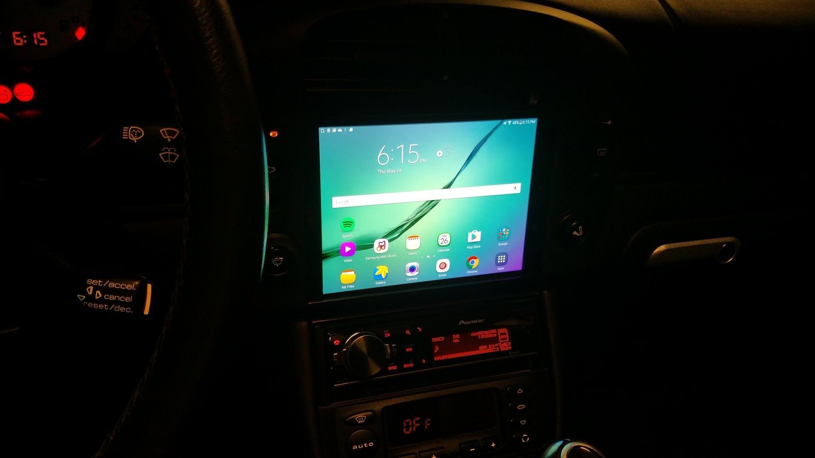

Has anyone tried this mod with an Android device? Specifically the Samsung Galaxy S2 8.0 as it for all intents and purposes is the same dimensions as the IPad Mini.
I just unintentionally updated my Ipad Mini original to 9.3.1, trying to fix a intermittent crashing of Waze. Hating it as it's sloooow now. Not to mention that it's not yet jailbroken-able.
The S2 seems to be a fair bit brighter AND it's and Android! GPS is built into the wifi version for those of you wondering.

So I took my own advice and am trying the Samsung S2 8.0 tablet....and the jury's still out.
FIT:
Fits just fine! Though the power input is just off center requiring that I trim a bit off the dummy button above my cigarette lighter. So if you have an actual button there, it won't work. Orienting it so the power cord is to the driver won't work as well as it fouls a button there.
POWER:
This tablet sucks down power! My Pioneer 80PRS was able to charge my ipad mini just fine with tablet on full brightness (1 amp USB). The S2 sucks down the power on full brightness (AMOLED display) such that I'm LOSING power in use. Grr. Possibly can be rectified with a hardwired 2 amp USB adapter. Also, in sleep state, this sucker does not seem to have good standby ability, having depleted itself in 3 days with wifi and bluetooth on. There might be a software solution, but so far...no good.
INTEGRATION:
This may be my deal breaker. My Pioneer 80PRS only has IOS device integration over USB. Does not support Android unless I use Bluetooth. Which sucks, cause I've loved the apple device on USB, as this allows maximum audio quality, to take advantage of my 3x burr brown DACS in my 80PRS headunit. Also, there is a slight delay on startup while I wait for bluetooth to connect, and I don't like that!
SPEED:
Wow this sucker is fast compared to my dog slow IOS 9 Ipad Mini original. Too bad, cause I liked the ipad just fine on IOS 6.
SOFTWARE:
I haven't completely figured this one out yet. Oddities with volume going back to 70%. I was hoping split view would work with both WAZE and spotify, but WAZE doesn't support it yet. And there's no convenient ACTIVATOR software equivilent... Trying to figure out how to get gestures set to, for example shut down the device without the hard button.
SCREEN:
She's a beauty. I was worried case the screen was rated just under the same brightness as the IPAD Mini 1. But OLED as a direct emitting technology, really helps here with the off axis viewing. Colors are sooo punchy and nice. And the psychological advantage of it being .1" bigger (8.0" to 7.9") =P
CONCLUSION:
There's several deal breakers on my specific setup with my Pioneer 80PRS lack of USB integration with Android. And the high power use issues that I've not fully resolved. IPAD 4 mini on order.

No one must be looking at this thread anymore. For posterities sake...
I'm back in an IPad Mini. Though an Mini 4 now.
The Samsung S2 8.0 was a no go in the end because of the power draw. It would lose charge WHILE charging (@1.2 amps). This is due to the AMOLED screen and WAZE, as a largely white picture causes huge power draw.
IPad Mini 4 is nice and fast! I'm back in my happy place. The IPad mini 4 is brighter than the Ipad original I had. Though at full brightness, it will only just retain and add charge barely. With the brightness at 80%, it will charge nicely. Though this is not really an issue cause of it's excellent standby ability. I have Activator putting the IPAD to airplane mode and sleep upon power disconnect.
I was hoping to have split screen working on both Android and IPad mini4 setups. Funny thing is that the Android version of spotify did not support split screen. On the IOS side, it was Waze that did not support split screen. Hope they will get their softwares updated shortly.
