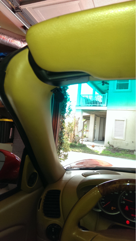

Originally Posted by dutch86
Okay, so I've had the iPad in my car for a couple of months now, and I absolutely love it. Two questions for others who have been there. 1) Where did you wire the microphone for the Bluetooth capable head unit? Has anyone wired it to the actual microphone area in our cars? Is this difficult? 2) Is there a way to have the app that was last running fire up when I start the car up? I pretty much only use the Waze app and control the music through the head unit. Thanks in advance. This is a great and relatively easy mod.
mounted my Mike on the upper left a pillar. Works great, can carry on a conversation with the top down no problem. I assume you have jail broken you mini? Actuator app will let you cut it off / on with the ignition. It will also let you power on in the last app you were using.

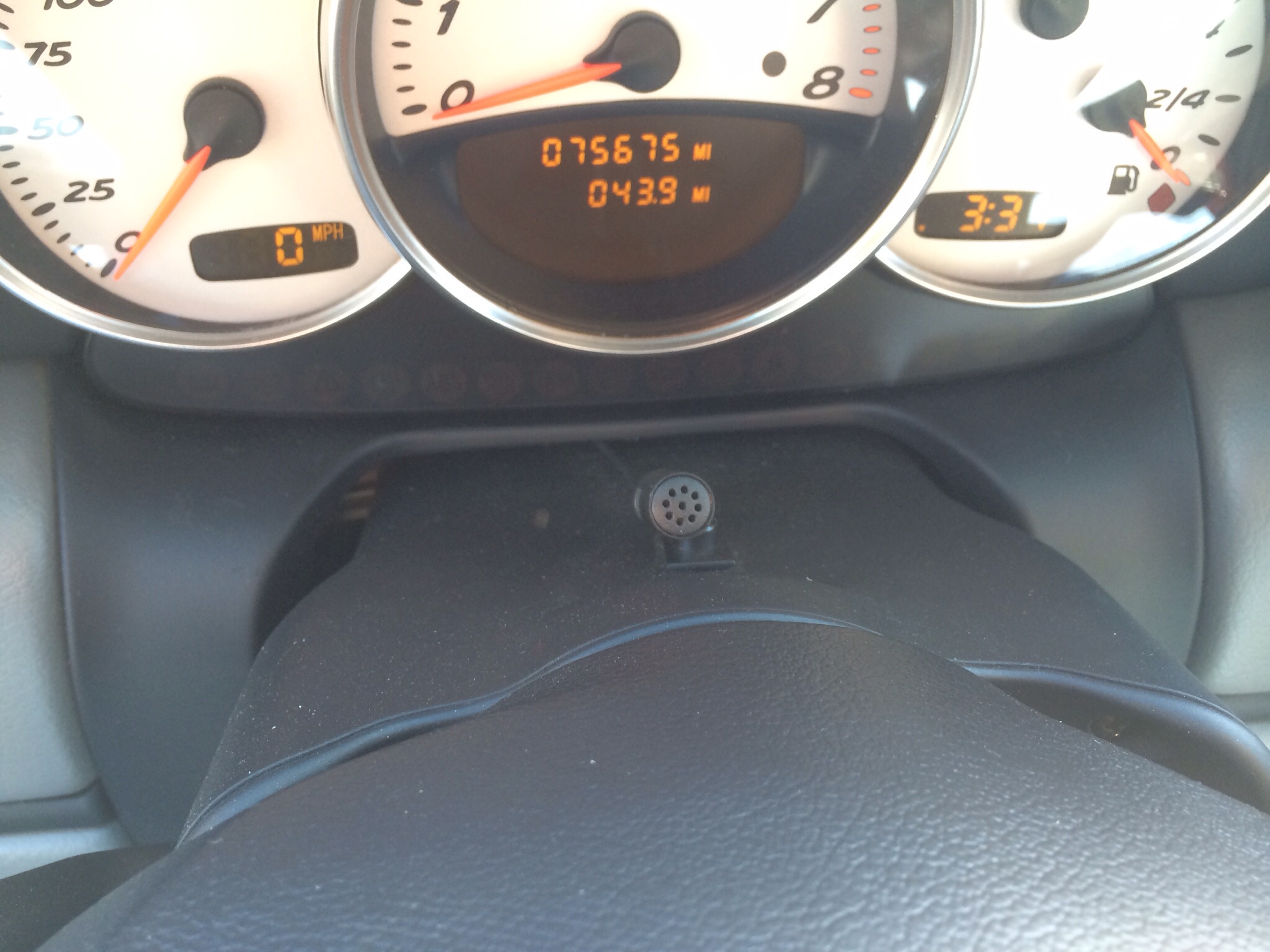

Thanks Rob! Any pics of where the mic itself lives? Is there an airbag to worry about in the pillar?
I have jailbroken the mini and have the Actuator app set up to lock and unlock it when the car starts (when ipad gets power). May have to look and see if there are additional settings.
Here are shots of my mic. No problems using with the top down, seems to be a good location. I guess I should have dusted before taking the pic

Old Feb 19, 2015 | 03:53 PM
Thanks Rob! Any pics of where the mic itself lives? Is there an airbag to worry about in the pillar? I have jailbroken the mini and have the Actuator app set up to lock and unlock it when the car starts (when ipad gets power). May have to look and see if there are additional settings.
Should be no issue with the airbag. The wire is to the side. Here is a pic. Name:  image-4159523671.jpg

Originally Posted by Slopeslider2
Should be no issue with the airbag. The wire is to the side. Here is a pic. Attachment 414537
What colour interior is this. Inside the garage with a flash it has a greenish look and im curious to know what interior gives this illusion?
Its Savnna Beige not sure why it looks green?
Thank you both! What did you use an adhesive? Is there something that won't ruin whatever surface it's on?
Ursa, I believe it is Savannah Beige.
If I remember correctly, the mic had a self adhesive on it. The surround is just plastic so it should be fairly durable whenever the time comes to remove the mic.
mine has a clip that slides down behind the a pillar.
