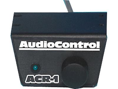

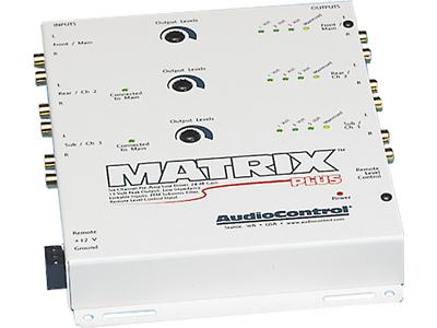

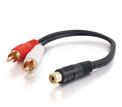

You don't have to run 3 DAC's. You couldn't even if you want to! The iStreamer plugs into the data interface on the iPad, so you can only connect one.
Option 1 is just use RCA splitter cables to run to all the amps inputs (the sub channel is mono, you only need to run one side into it).
Better option is to use something like the
Audiocontrol Matrix Plus Audiocontrol Matrix Plus
, which will take the high impedance signal from the iStreamer and separate it out to up to six channels. It also has an optional
'volume remote 'volume remote
' so you don't have to try and use the ipad itself as a master volume control...
You can disassemble the remote volume as well as change ***** to give it a much more custom appearance.
Though splitters like these will probably work fine if you have enough gain on your amp...
