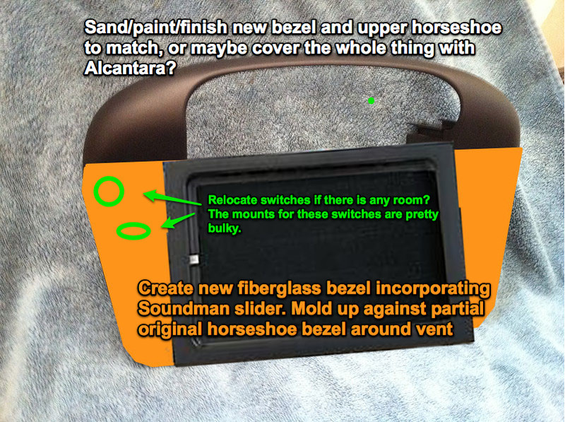

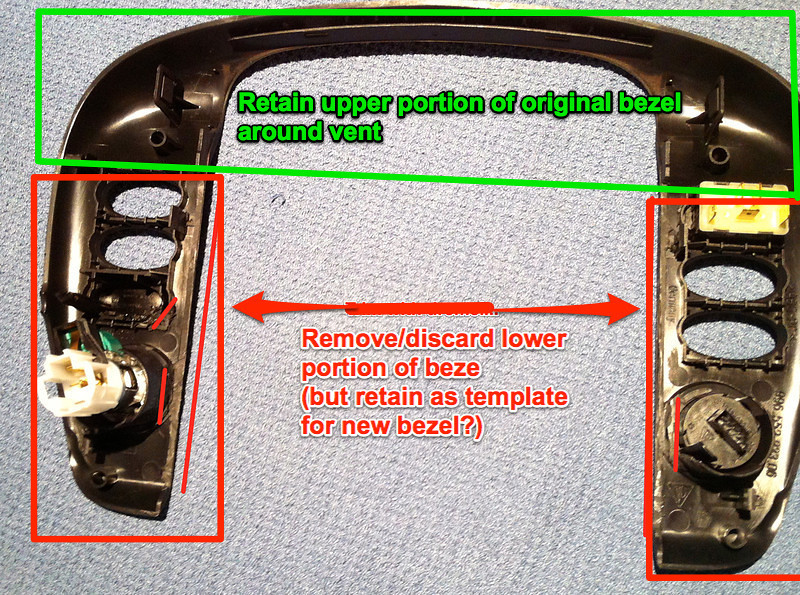

Originally Posted by Diesel117
I am not a fan of saying something cannot be done but there is very, very little room beyond having the mini in there. It can be done but you would have to relocate some or all of the buttons and dials in the horseshoe. You would have to get rid of the cup holder tray as well. A lot of custom work ahead of you to do it well.
Agree, it would be a fair amount of custom work, but the more I think about this, I think it could be done. I suck at molding fiberglass, but if I had some skills in that area, this is how I would go about it...
  1. Retain vent as is
  2. Plan on relocating cig lighter, windshield speed control, and all horseshoe switches.
  3. Cut away bottom part of horseshoe bracket. Use top part as bezel for vent.
  4. Trim inner dash panel to provide enough clearance for Soundman Slider.
  5. Fashion new fiberglass panel holding slider, fitting up against upper horseshoe, rest of dash** (this is the part that a skilled fiberglass guy could probably do easily, but it would take me forever).
  6. Refinish custom bezel and upper horseshoe bezel to match, maybe cover in Alcantara?
  7. Add switches/lighter/windshield control to new custom bezel if there is room, or relocate to lower console.
Basically what I said but more thorough, lol. I have got to learn photoshop.
You will end up with a frankenstein horseshoe. Alcantara or leather would be a good cover if it went with your theme.
If I were doing this I would make a mold of the frankenstein horseshoe and then re-cast it. You would have a custom, one piece horseshoe. Either way, you would want to make sure to sand the part smooth. The little details will make or break how good it looks in the end.
Don't be afraid of mold making. I have done some cool things as a beginner. Lots of great products and info here:
http://www.smooth-on.com/
http://www.freemansupply.com/
http://www.uscomposites.com/
