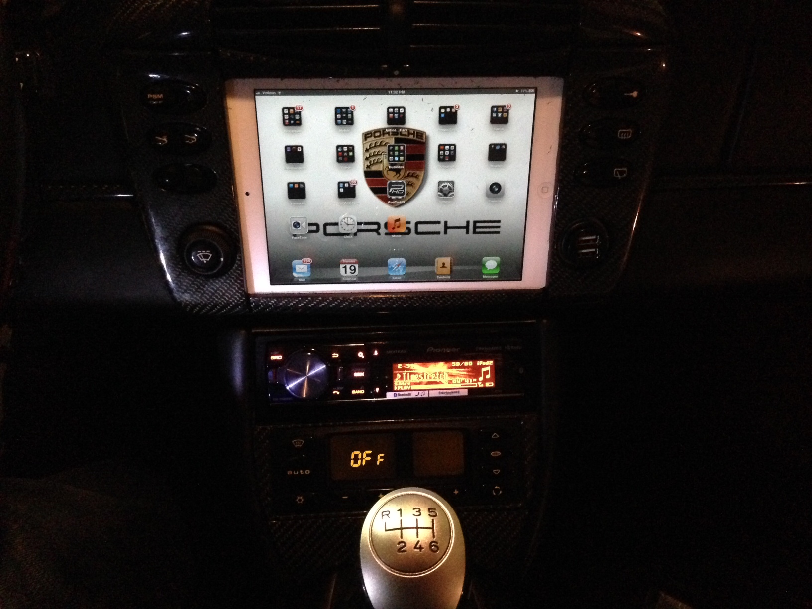

Ok. I completed, well mostly, this after 5 hours. The previous owner had installed a full din and the wiring was too short to move down. I removed the non factory wiring and then started fresh. My cuts on the one side of the horseshoe are not exactly straight, but I clean that up in the near future. Overall it looks great and operates perfectly. As other have said the pioneer orange does not match the OE color, but it works for know. Thanks to all, especially PFBZ and Mspross.

Here it is:
I still have to run the sat antenna. But all else is running.
To install the radio in the upper cubby, I had to file the left side of the pocket down an 1/8th or so for the radio sleeve to slide in. That was it. Having the carbon fiber trim made me hesitant about grinding away. I finally decided the worst thing that could happen is I buy a new assembly. Thanks again all.

With the Pioneer, go to the "custom" color and dial it in by tweeking the three color bands. I had it matched perfectly. Then down the road I had to disconnect the battery for a door repair and never wrote down combo I had. One day I will get it just right again and post the R, G, B combo. Each go from 0-99.

I think I read somewhere, that there are dremel bits for plastic, that you can pick up at Lowes/Home Depot. I didn't have them, but, it may be worth looking into.
Yep. There are cutting disc just for plastic. Makes great strait cut without that melting junk on the edges. That is how I got mine so clean. No one that has been in my car can tell I did anything to the car.

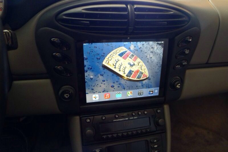

Here is my iPad mini installed in my 2001 Boxster. Thanks to the OP for this thread and inspiration! The install turned out great IMO with just a few headaches. Relocating my CDR-220 to the lower console was a bit difficult since the harness was just a bit too short to fully pull out the radio. I solved that by cutting an access point on the left side of the lower console. Here is a shot of the finished product!

Thanks! Here is a wide shot:
