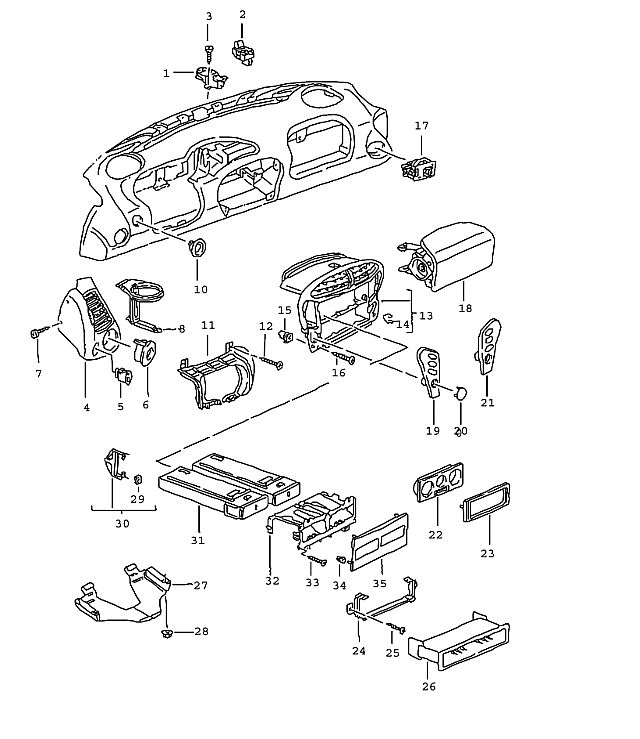

Okay, first off I think this an awesome mod, and I'd like to get started on this, however I have a couple questions to help get started the right way.
I have a 2001 with the stock PCM1, so I'm trying to locate a CDR-220 to swap into the location that the current nav cd slot sits. This seems like it should be pretty straight forward, I just need to make sure it has the serial number on it so I can have the guys at rennlist get me a radio code if one isn't provided with it.
Next, I've pulled my stock unit, and since I have a doubledin in there right now, I don't have the divider pictured below that is being used as a brace to hold the ipad mini in place. I'm having difficulty finding this part number, any help would be appreciated.
Finally, I have the wood trim, and my horseshoe comes apart in 3 pieces (left, right, top). I notice the instructions for trimming the back plastic area, and I'm just curious if my different horseshoe design would create a problem with this. I really don't want to put the plastic bezel in as it would look odd having the rest of the car still in wood.
Just curious about some of these questions/potential issues.
The back supporting divider I'm talking about can be seen in these pictures:

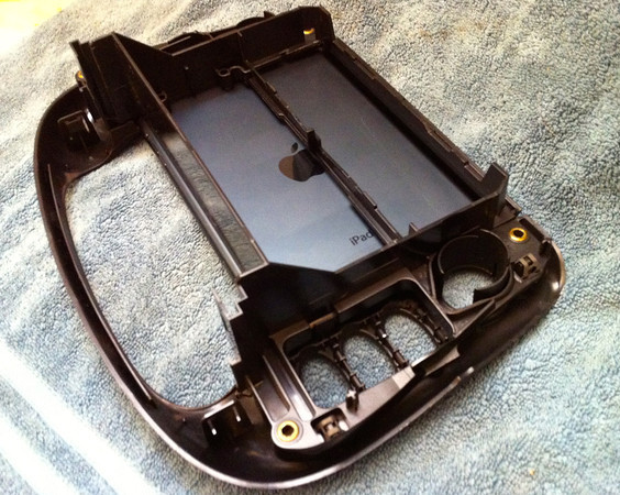

99655223306
99655223111
these are the numbers for the radio support shelf and the standard horseshoe. like the others i would get both and practice on the horseehoe. if you get the fit right you could work on the wood trim piece. much cheaper if you mess it up. autoatlanta, ebay and sonnen porsche all have the pieces you are looking for
worst case you could have the standard horseshoe hydro dipped in wood grain to match your interior

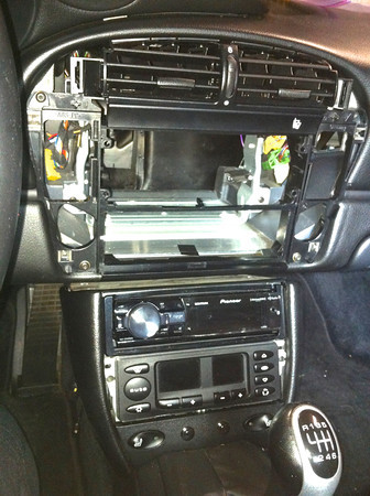

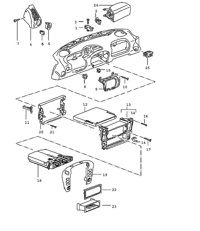

I did this mod on a 2004...
1999-2001 have different center console parts and different cupholders than the 2002-2004. I don't think that just buying the 2004 horseshoe and radio support will solve your problem, as the air vents and cupholders are different as well.
I'd take the general idea of what I did in the first post and see if you can apply it to your configuration....
1999-2001:
2002-2004:
