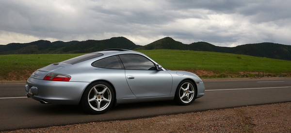

Four month check in from my original install...
Haven't done to many more interior mods, though a few new exterior upgrades!
Still super happy with the setup. Extremely cool/useful at the track as well when set up with Harry's Lap Timer. I get great GPS signal reception, even buried in the dash, which was a bit of a problem.
The Pioneer unit functions quite well, and the ergonomics are good but not perfect. One issue I have is that while I can set the display color to a very close match to the Porsche lighting, it becomes pretty difficult to read at that particular color/intensity with my sunglasses on, so I've changed it to a blue/white anyway for legibility, offsetting one of the advantages of the Pioneer unit (color match).
Pandora and Waze are pretty much running all the time, and I honestly can't imagine driving in a busy urban area these days without Waze.
Congrat's to all the folks who did their own installs, they all look great!
