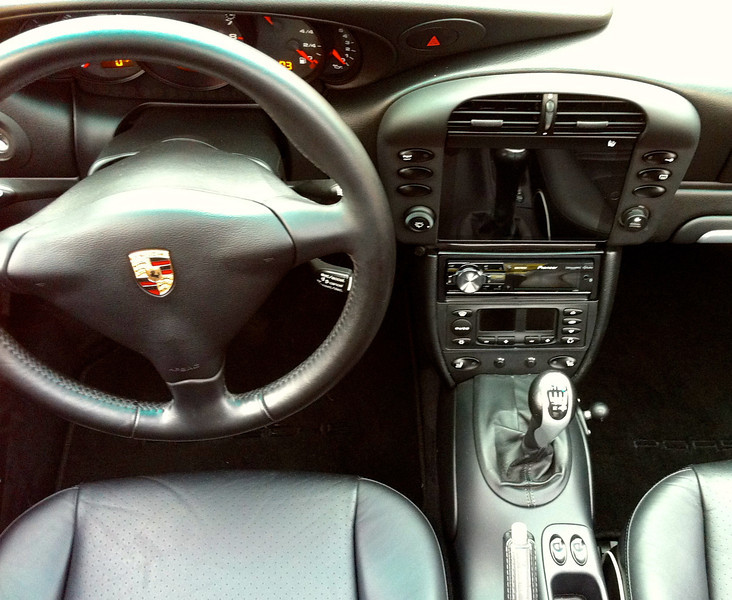

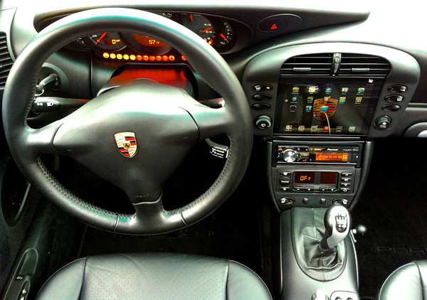

A couple of better pictures of my final install. Get in, turn the key, pandora starts streaming. Absolutely no buttons to press or changes to be made, unless of course I want a different pandora station, or my local ipad music, or slacker, or ....
Pandora station displayed on Pioneer head unit, as well as song.
Off.
On.
The two little round buttons below the hvac control, next to seat heater switches are my garage door / gate opener hack, still in progress.

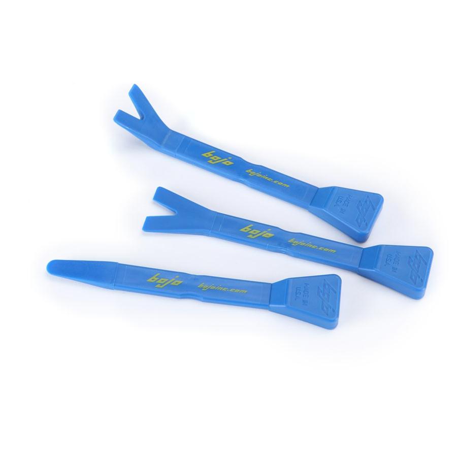

Right tool??? I think last time I did that I just used a screwdriver, carefully. Do you have a trim tool you'd recommend?

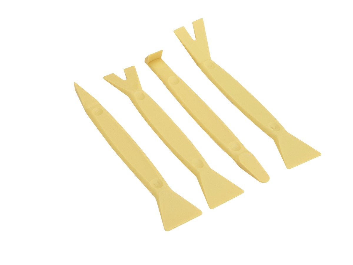

You can use a screwdriver (carefully), your fingers, a plastic spatula, or whatever, but a set of nylon pry tools is really nice especially with the Porsche, which uses spring-clip fittings everywhere...
Fairly inexpensive. Bojo trim tools are excellent, but even the $5 harbor freight set is far better than using a screwdriver.
