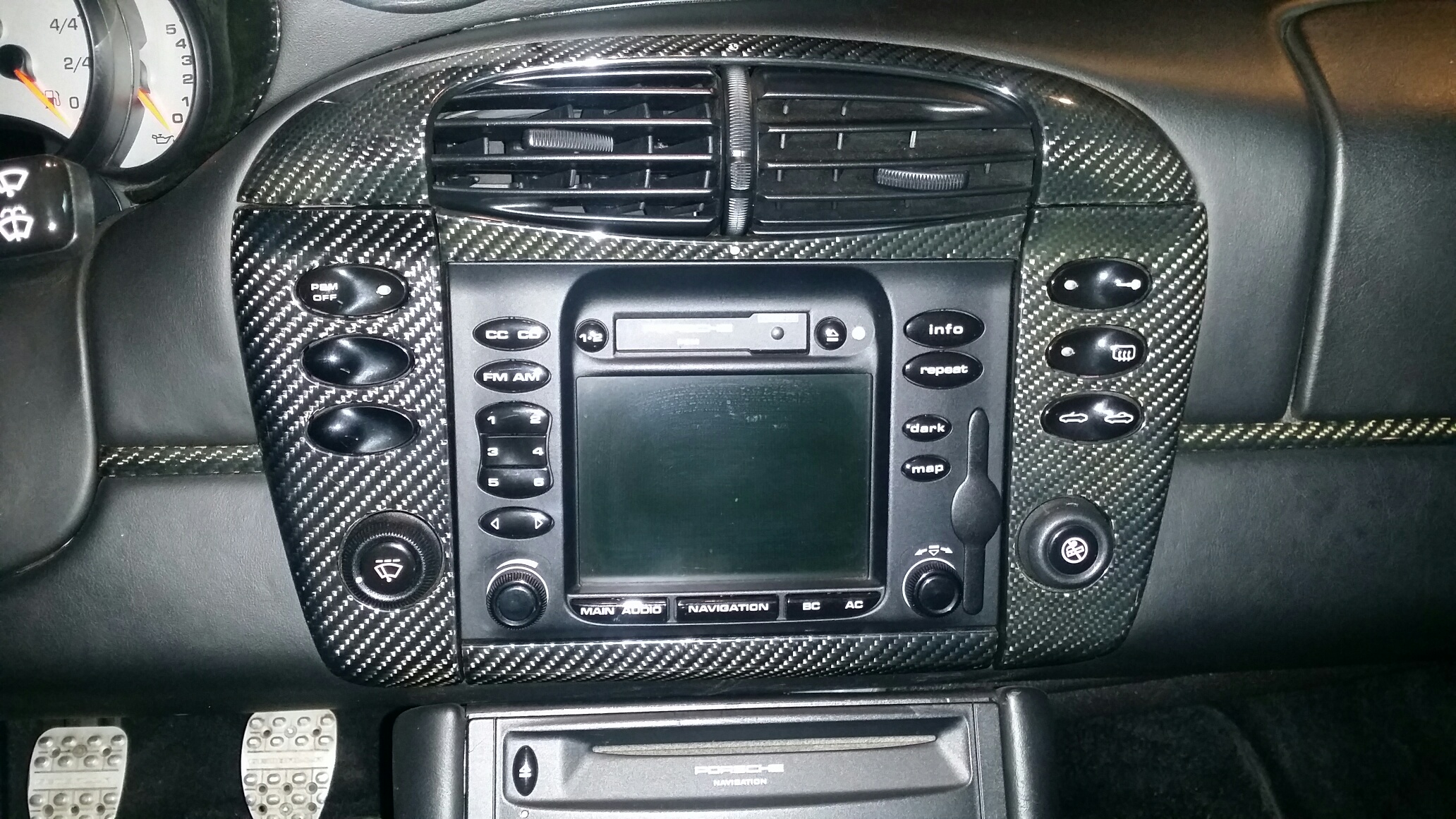

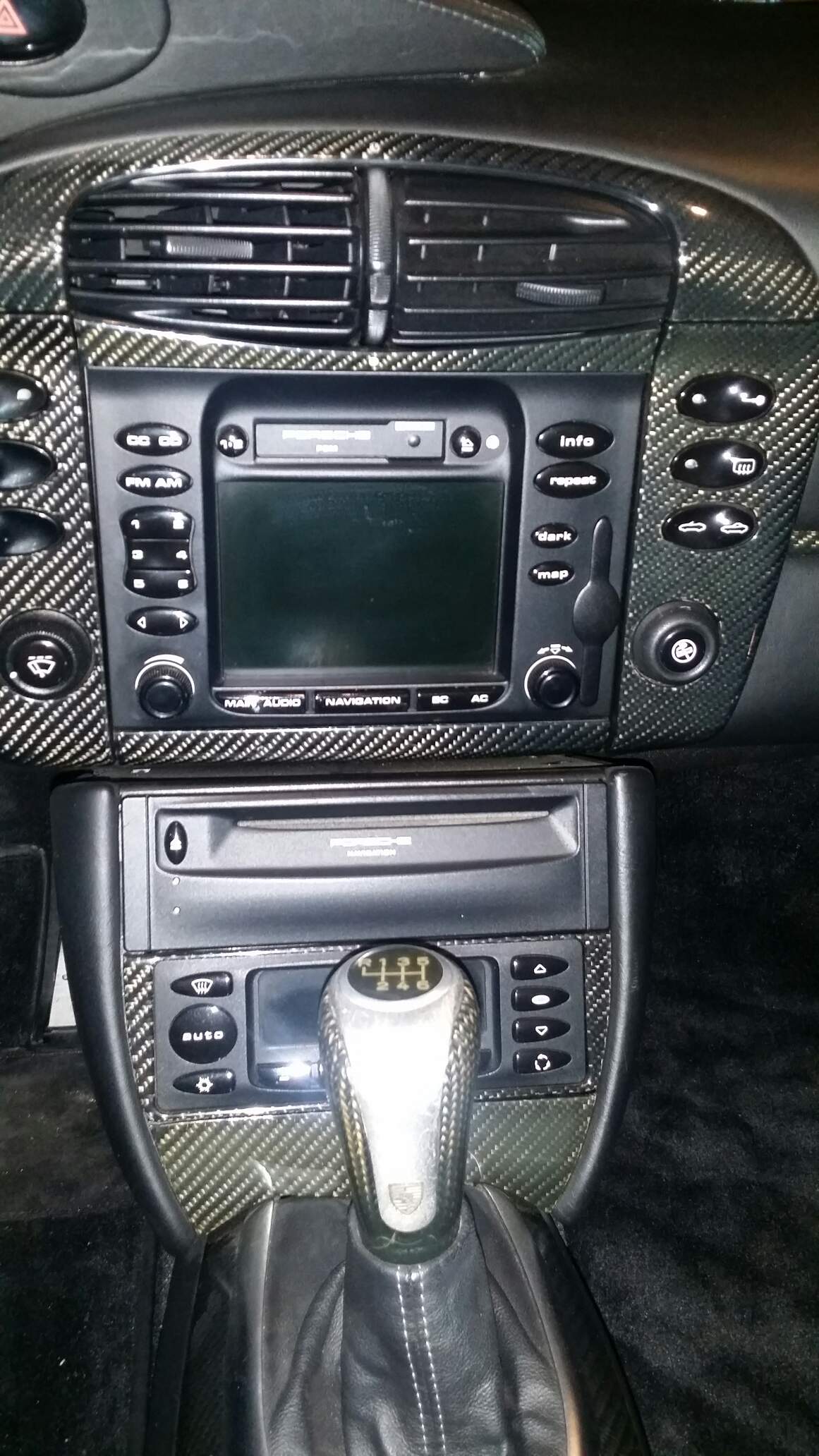

Like PFBZ I have used my ipad in all my cars, usually with a RAM mount. BUT as my wife keeps complaining of the intrusion into her leg space (I have a standard sized ipad) and its not aesthetically very pleasing, I have been inspired by this thread to try this ipad mini install in my, new to me, 2000 996.
I've been researching various things, including the jailbreak for the ipad, and it seems that there is not a jailbreak for the IOS 10 which all the new ipad mini 4s come with. Do you recommend I buy an ipad mini 3, or has anyone who has a mini 4 found a workaround to the ipad being turned on/off with the key?
I have attached a picture of my current setup. It also includes the Porsche CD changer in the front. Can anyone give me any advice as to what harnesses/equipment I may need? I was very surprised that Crutchfield, who I have used extensively over the years, could offer me absolutely no advice. Please tell me that our Porsche stereos or this install isn't so difficult that even the "experts" dare not venture there?

I'm thinking the Pioneer DEH-X8800BHS head unit, as it seems to be the only Pioneer unit that I can find with rear USB input (we have Pioneer head units in all our vehicles, that way it doesn't matter which one you are driving you will always know how to operate the stereo. And that makes my wife and I very happy I have ordered a plastic trim to practice the trimming work that will be required, before cutting up a carbon fiber one. I'm not sure what speakers are being used in the system.
Although I'm reasonably adept at this sort of thing (I have installed at least 5 Pioneer upgrades in different vehicles, mostly German), I'm not a techno wizard, so don't necessarily use appropriate terminology or speak the techno language. Also unfortunately for me at the present, I'm working away from home,so I cannot just pop into the garage to check things out. My wife has to do that for me and she is in no way a technical person. She can follow very specific instructions (She took some of the pictures you see attached). Having said all that, any advice/help would be greatly appreciated.
Thanks for any responses in advance, as I know this thread started over 4 years ago and the last post was nearly a year ago.
