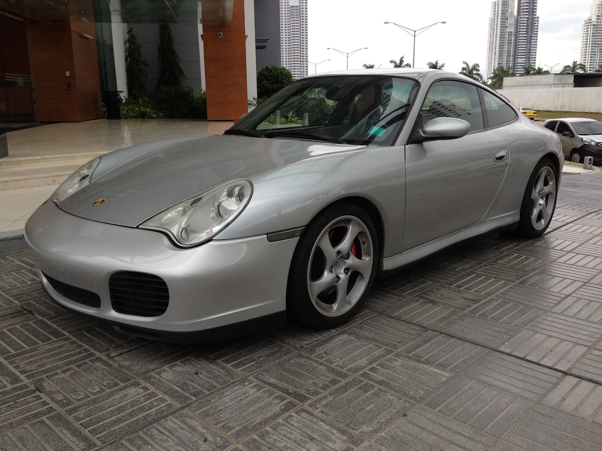

2- Headlights: is it normal to have a gap almost the width of a finger between the bumper cover and the bottom part of the lights? In my old 99C2, they sat pretty flush. The passenger side one has a lot of scratches (as if someone cleaned it with sandpaper ). Is this something that could be easily polished out? Anyone know what products and procedure required for this?

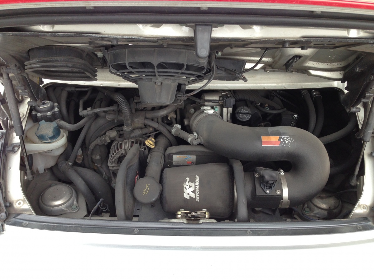

5-K&N Drycharger: gotta search for this one.. It is installed now, not sure if owner has original air box (which I prefer). We get tons of rain down here, so not sure how this will perform in rainy weather. I am also not a fan of replacing MAF sensors..
Obligatory pics (taken with cell phone ) enclosed and hopefully will give you a better understanding of what I am dealing with.

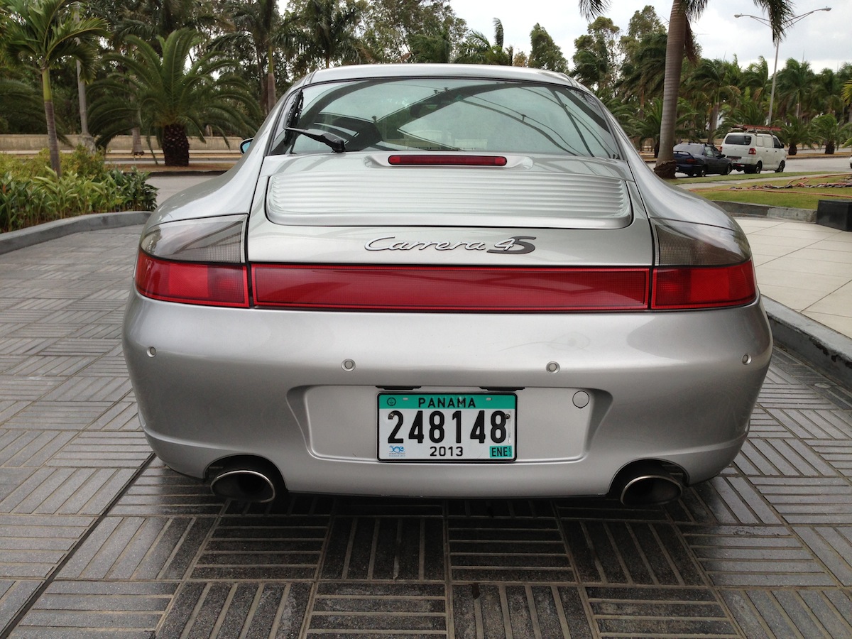

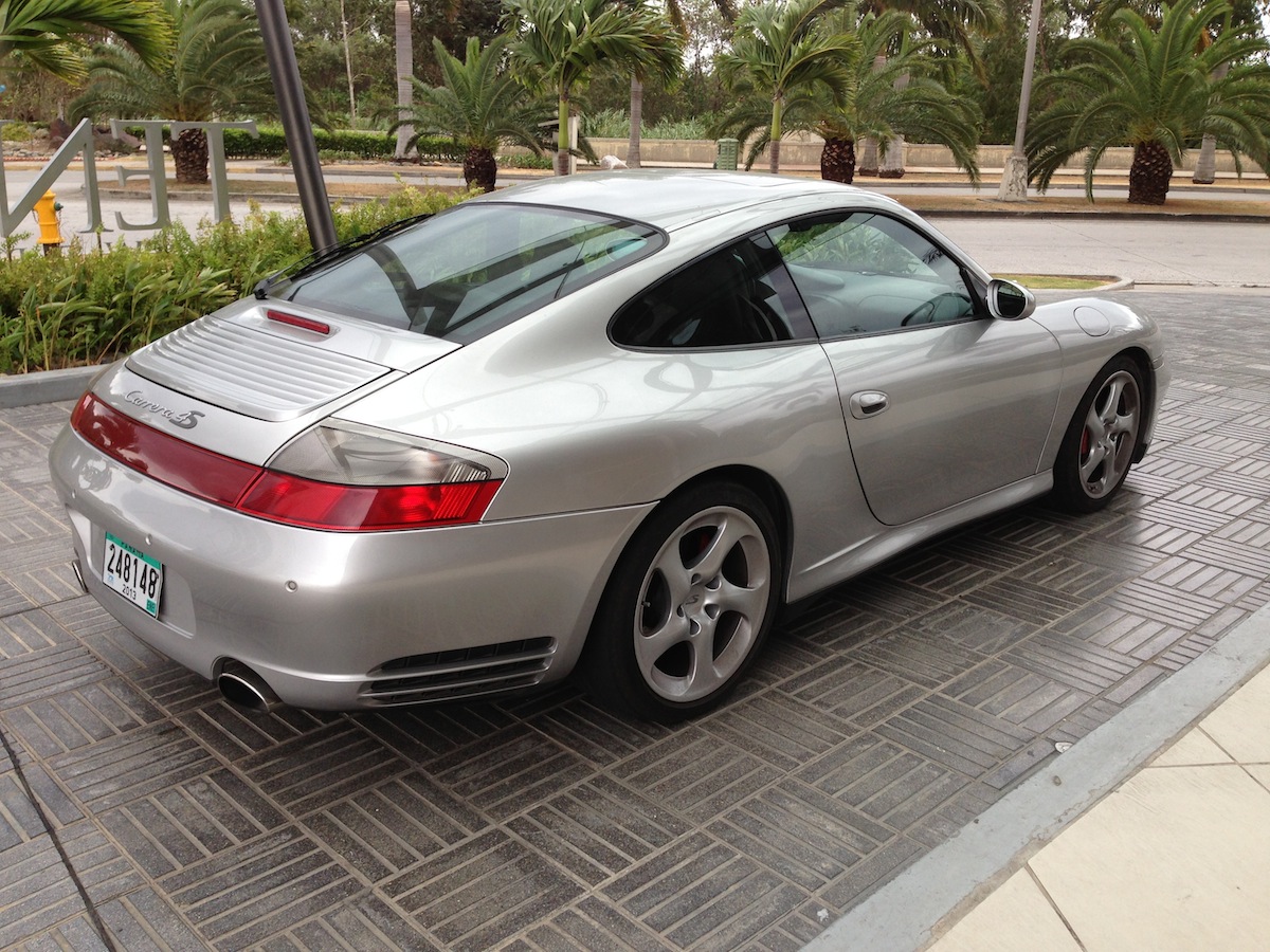

additional pics
of the car itself this time

The pics of the outside look great, however, if it were left up to me, i'd be walking away. Anyone that let their engine get that dirty obviously did not take care of the car, and I'm wondering what else is wrong or will go wrong in the future.
I noticed youre in Panama, so im not familiar w the market down there and what other comps you might find.

Detailing engine bays here is not a big thing. You can detail it as much as you want and in a week or two it will look like that. There is a lot of dust/dirt/rain around here, so keeping something looking mint is next to impossible. That said, I do agree that the current owner could have done a better job of keeping things tidy.
This car, two owner, 28K miles, all services done and up to date at the local dealer, has its history well documented. Options are few to none, so it's either this or nothing as recent job changes make buying a more expensive toy something imprudent. I will perform a PPI and look over the service records myself first thing tomorrow morning so I can then make my offer.
Only items that really concern me are the starting issue and the fact that the AC blows cold, but not too cold. The foam used on the air ducts is coming apart and I believe an AC failure is pending in the not too distant future. Hopefully topping off the refrigerant will bring it back to icy cold vs just "cool enough".

I also found on another forum that 3M has a headlight polishing kit that apparently works miracles. Better results can be achieved if prior to using the 3M kit, a combination of wet and dry sandpaper in various steps is used from 500 grit to 3000 grit.

Yup, I read up tons on the K&N too (wife NOT happy that I have spent all day sitting in front of the computer reading stuff about the car )
The sock should help with the water intrusion. Among the questions pending tomorrow are if the original air box is available and if there are any specific MAF errors logged.
Some say that K&N makes hp, others say it loses HP, all say it improves sound, some say that it messes up MAFs, others say that MAFs are not affected if oiled properly. As it stands now, the car has it, no CEL lights, it does sound VERY nice, but I am more concerned about saving the $15K lump of metal sitting behind the rear seats than anything else

2. Hard to say about the gap, I don't notice this on mine, and as for the scratches, a 3M headlight restoration kit, or a day trip to a friendly painter will make them like new.

5. I have this in mine too, and the original air box which I may or may not refit one day. MAFs ok so far and its been in for 15k. You can fit a 997 air box easily and this make the engine look much nicer, again an ebay or breaker item and a popular upgrade, which means there are also 996 ones kicking around.

I stick an old tea towel over mine when I wash the car and park in a garage at home and a basement at work, and have no issues. I have been in serious rain with no problems, but I don't have the sock which would be the recommendation.
The oiling properly is the key as you have spotted, the spray can version of the kit and then wrapping in kitchen paper towel for a couple of days is the recommended way to not glue up your MAF, I also clean my MAF with CRC MAF cleaner (isopropol in a can) every 6 mtgs as well. For the oil, its just a small amount required, a tiny amount in fact
If the MAF goes, the engine light comes on, you try and clean it, if that fails, you buy a new one. Engines don't explode or bust into flames if the MAF fills up with oil. It is a service item and I plan on a new one every 5 years. Reminds me to buy one and keep it on the shelf.
