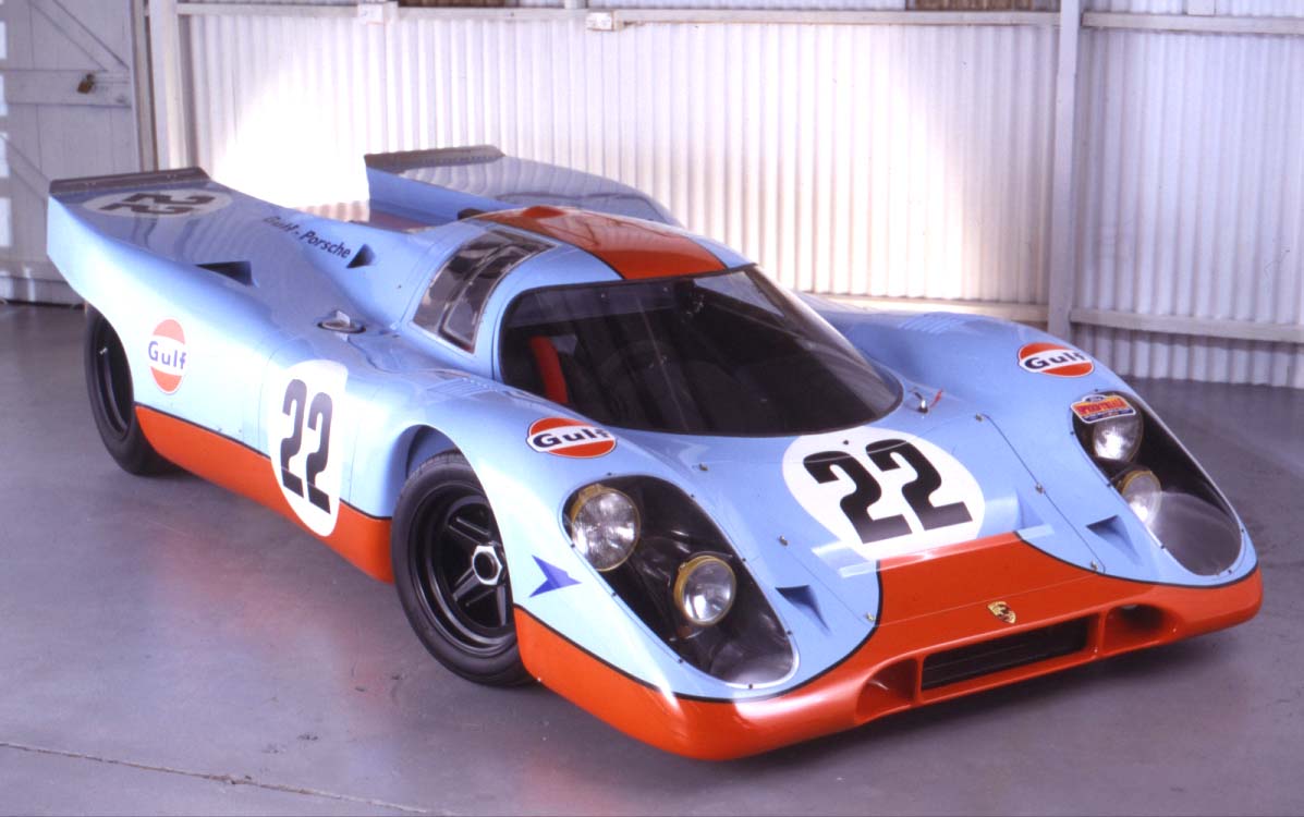

The day your beloved BMW can compete with the 917call me....
