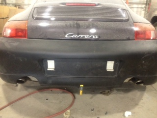

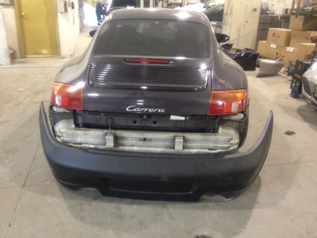

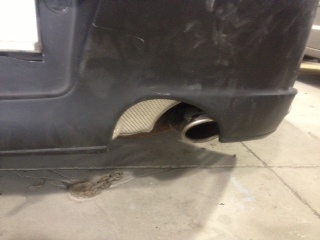

I'm looking to update my 996 with a GT2 style front bumper, TA skirt, and turbo style rear bumper. I've paid a visit to the bodyshop today to see how they're making out and to my disappointment, things are now going as well as I would hoped. The bodyshop is running into all sorts of challenges with the rear bumper installation. The muffler does not align with the bumper cutouts. I've included some pictures and I'm wondering if those folks who have encountered similar challenges could share some tips on addressing them. The bodyshop will be removing the mufflers in order to complete the bumper installation. I will have to take it to a muffler shop later to see if they can align it.

seems like you will need the C4s extension pipes (not sure if that's the right part name), but essentially it looks like you need your exhaust to align with the positioning on a C4s or Turbo model.

the front rebar does have to be cut or painted to blend in, the rear bumper is usually cut down the middle in the rear and narrowed a bit as it is too wide to line up with the narrow body fenders....this is not a bolt on process....look into it, it's more involved then most want to deal with thats why there are aftermarket companies that have created replicas that bolt right up.

To make the exhaust outlets line up right you'll need the C4S connection pipes and a set of clamps. Suncoast has them, (around 130 for the pipes).

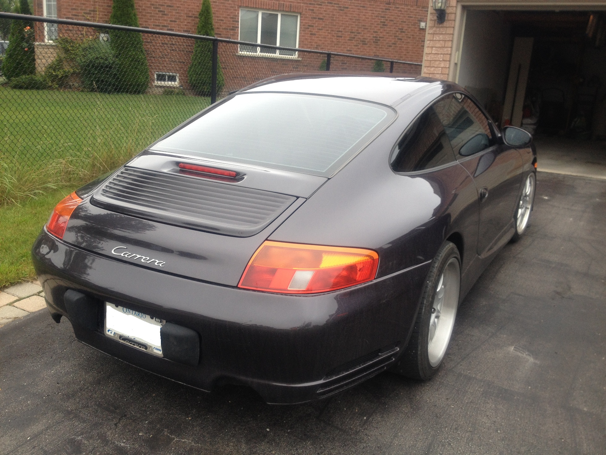

Deversteve, I did my research and ordered the narrow body rear bumper. The mistake was the vendor who shipped me the incorrect body. The vendor recognized his error and is willing to exchange the bumper. I won't reveal the company name as he was willing to correct his mistakes.

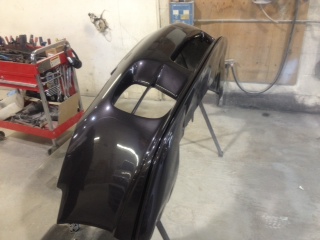

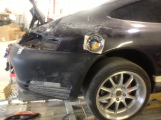

Anyway, I've decided not to return the rear bumper after further discussion with the body shop owner. He had additional time to reassess the challenge and explained to me his plan on trimming/modifying the bumper. I told him I've read on the forum about custom shops narrowing the bumper by cutting it in half and resizing it. He disagreed as he stated it will weaken the bumper. He took on the project without increasing the cost of his original quote.

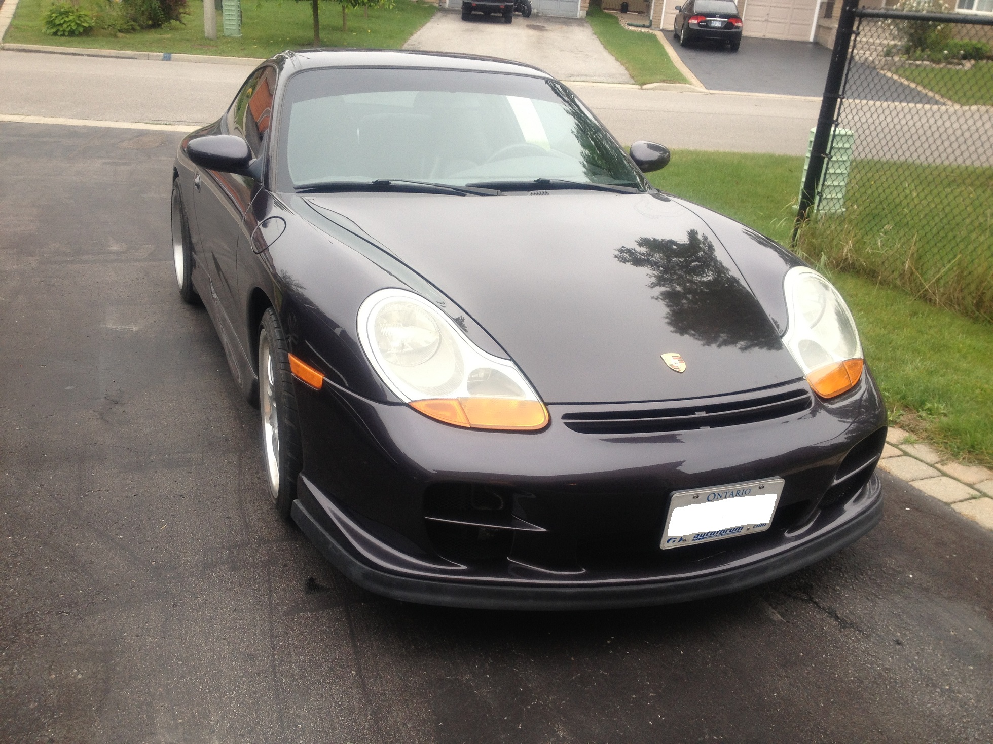

I've included some pictures. I've included a couple of pictures which was taken today with the owner cutting the holes for the rear license plate light and one of the front bumper ready to be mounted. There is also a lip for the front bumper (not shown) which is painted black.
The car will be ready tomorrow ... I will take additional pictures of the complete project.
Snowball, thanks for the info on C4S tailpipes. Will the tailpipe be a direct fit or will it still require a muffler shop to modify it? I was planning on taking my stock tailpipe to a muffler shop to extend it..

The C4S extension pipes are a direct fit because the cans/mufflers in the C4S and C2 are the same. I know this because my C2 has this set up. The pipes will bring the exhaust exit points further in towards the center to line up with the bunper. You will however need C4S exhaust tips. I got mine from Maxspeed, they are X50 replicas and look great. Here's a link to the website:

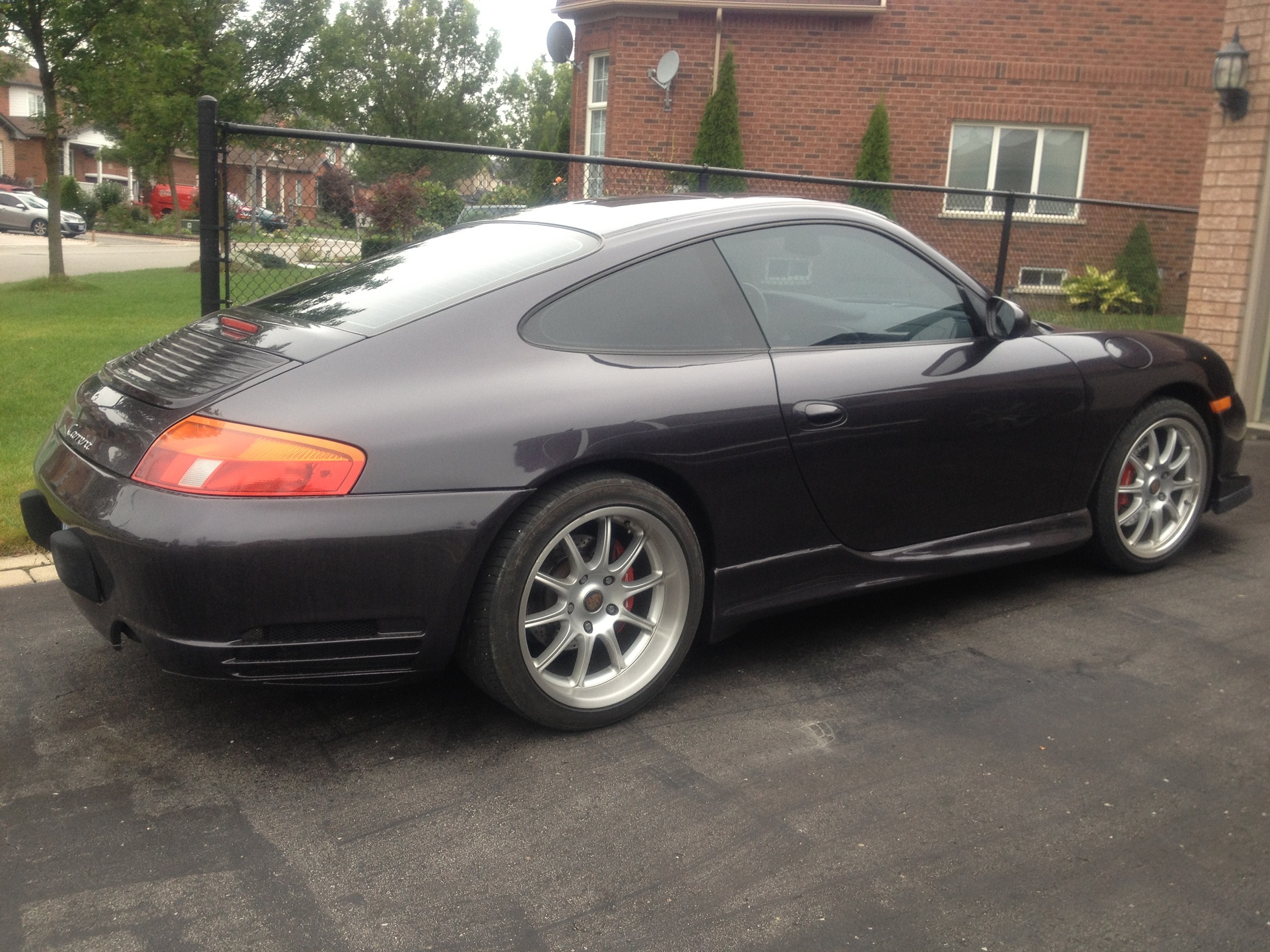

I'm hoping to be able to reuse my tips. I'll take it to a local muffler shop and see if they can extend it. I've included a few pictures of the completed project. I'm contemplating whether I should add a GT2 rear spoiler next ....
