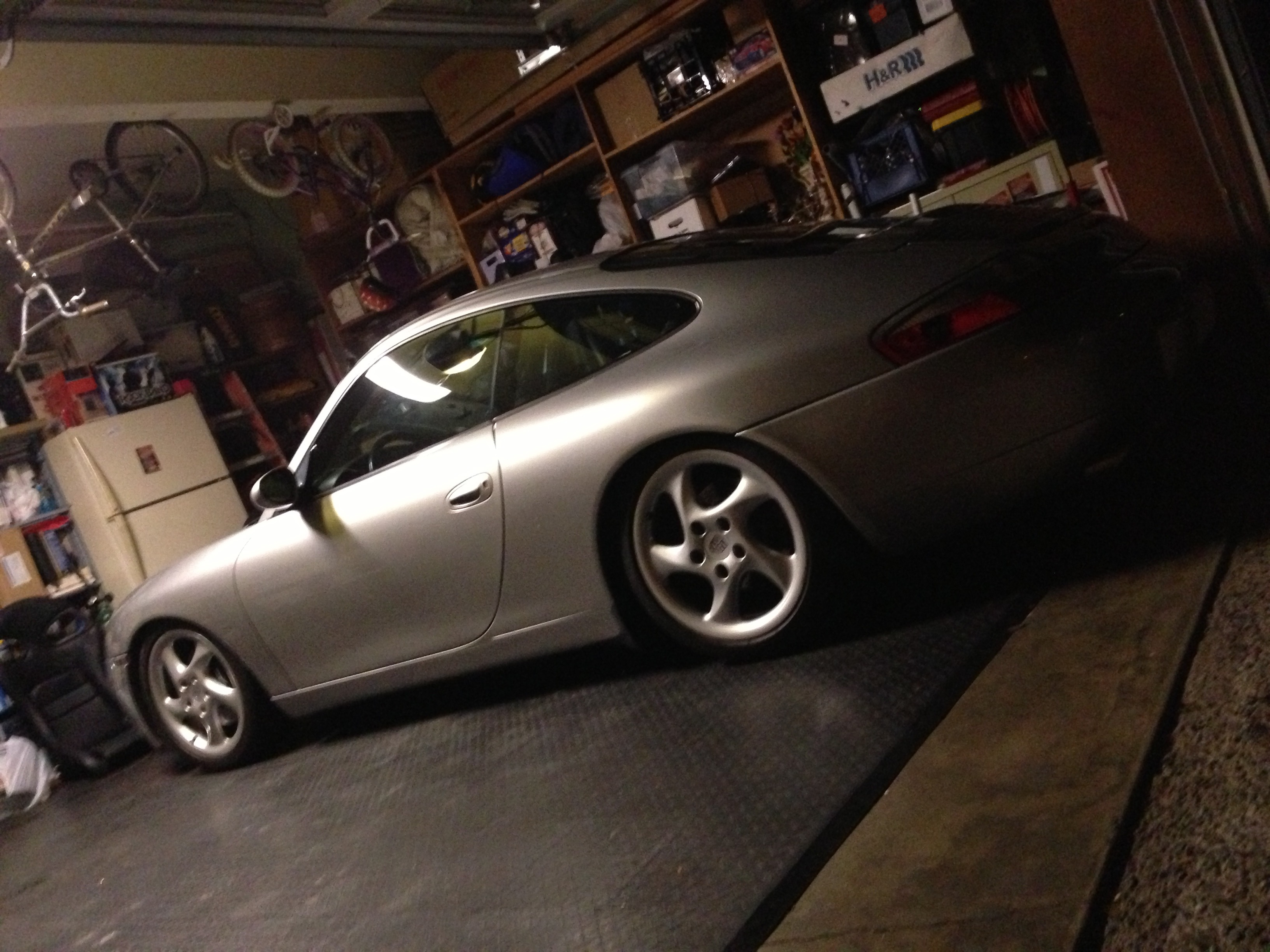

Just completed the coilover install. Project wasnt too bad. Took about 4-5 hours and 2 people. I think we spent most of our time trying to jack up the rear. (Please don't mind the messy garage)

Nice, very inspiring. Trying to get a buddy to hook me up with a set from his performance store. So many options. What kind of coilovers did you get?
