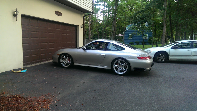

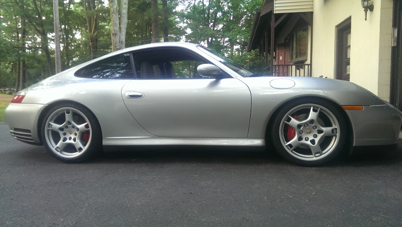

Yes, they fit. It's what I got. The offsets of the lobster claws are 51/58 I believe, while the stock 996 C4S wheels are 45/50. They will look very tucked in, but fixable with good spacers. I actually left the fronts tucked in as it keeps **** from getting kicked up into the bodywork. I got 15mm spacers for the rear, with studs.

Yes, good point. The ones I got were from a C2S. The 997 C2S is actually wider than the 996 C2, so the 51/58 offset comes pretty close to the 996 wide body offset.
