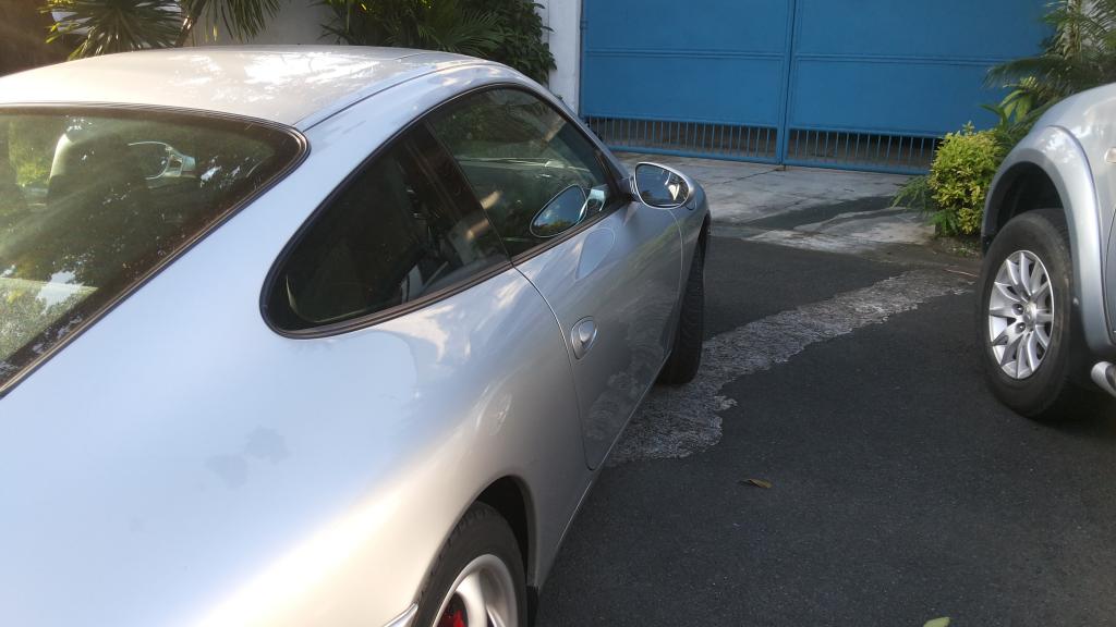

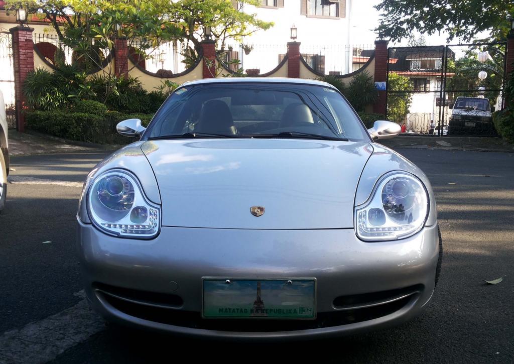

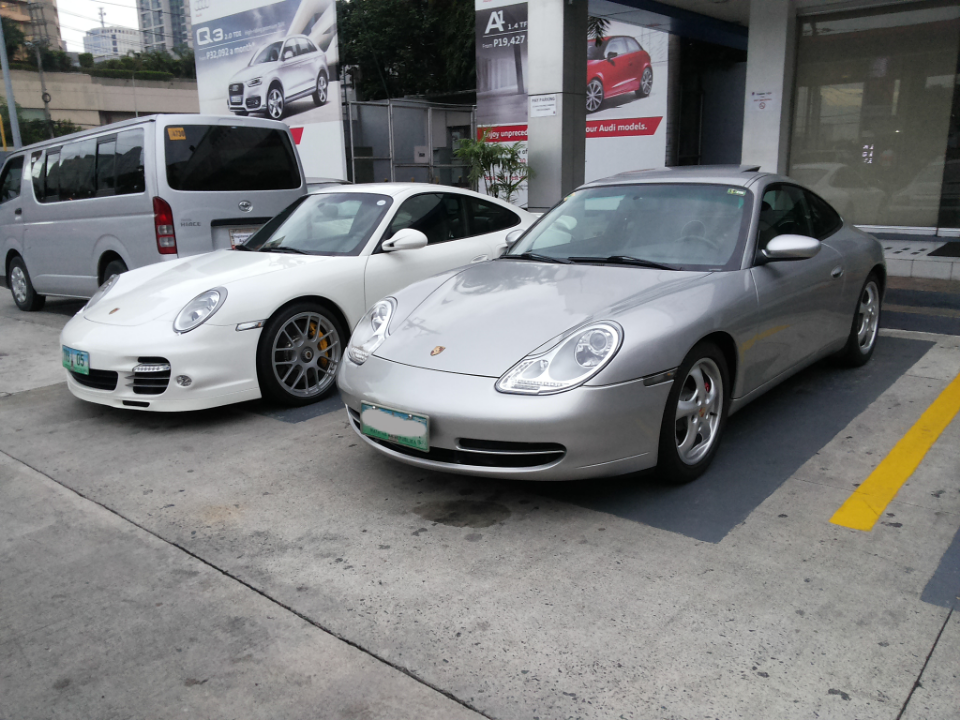

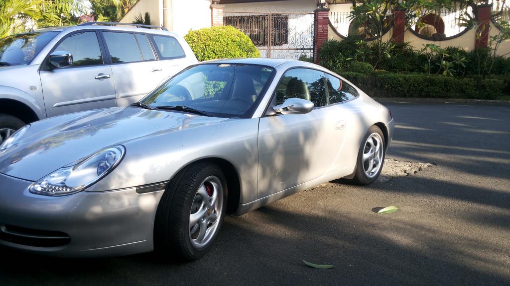

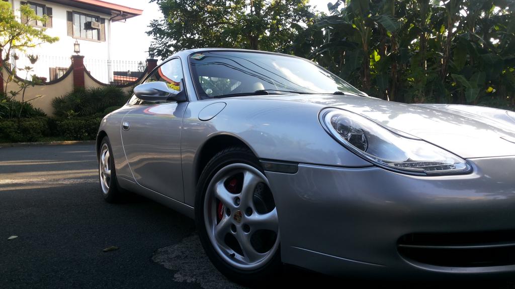

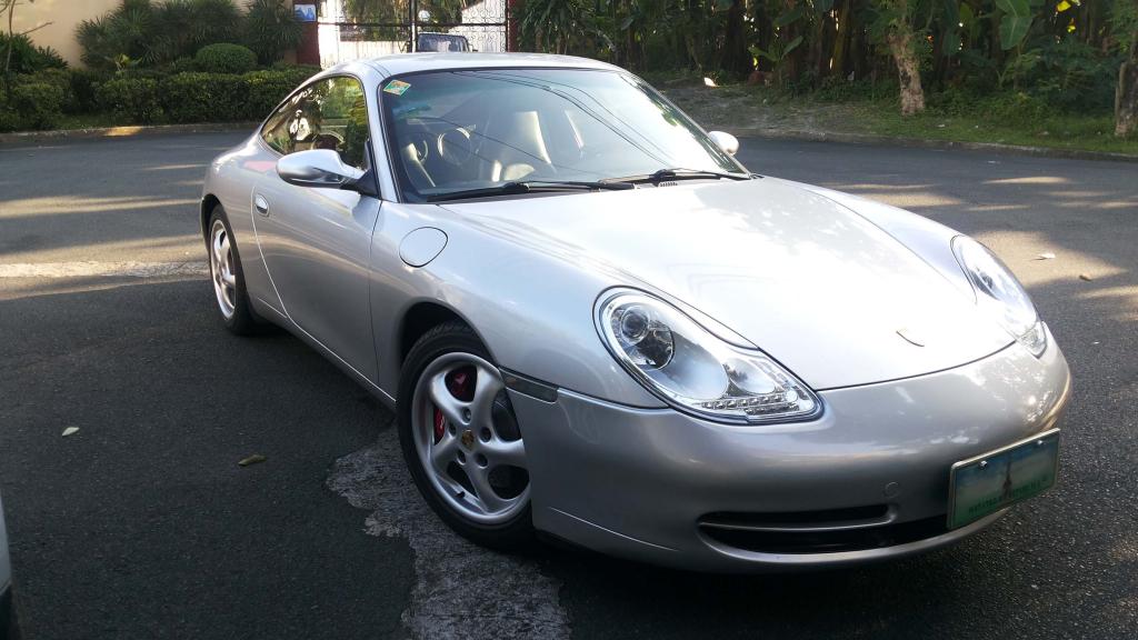

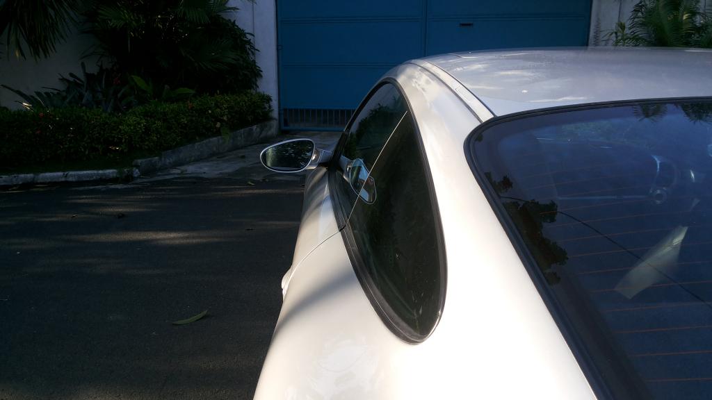

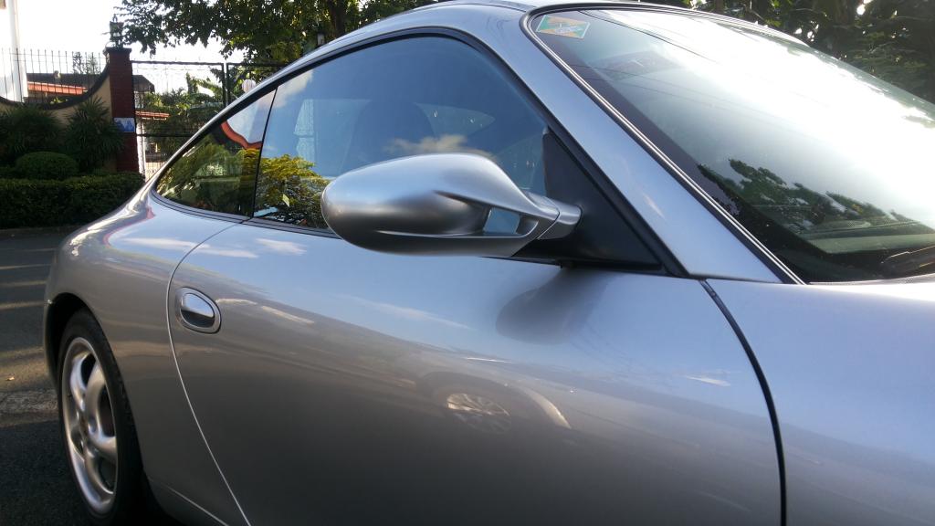

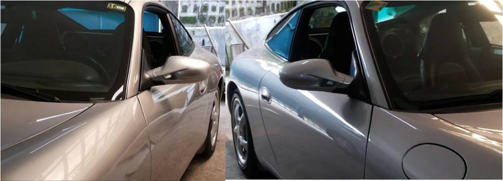

Hi guys! Here are some pictures taken from several angles of my pcar with the 997 side mirrors. I also have the last picture with my 996 beside a 997 of a friend just to compare.
I hope this helps...
Thank you for the photos...your 996 is coming along nicely!

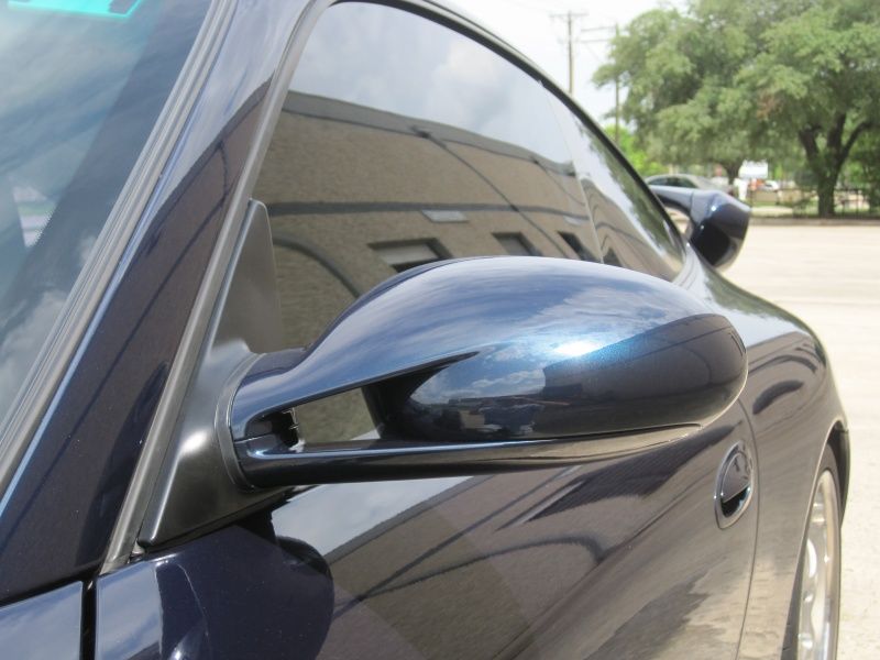

that turns out very nice..I did the same thing few years ago but with Oem 997 mirrors..it requires a few drilling but well worth it..
