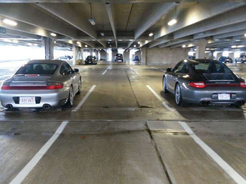

996's have some fine design details that the 997s seem to have lost. Vents on the rear bumper, the flower petal exhaust tips. These seem to have disappeared on the 997s.
The difference between a narrow body and wide body was more pronounced on the 996s. I think the 997 wide bodies are still wider, but not by that much, compared to the base cars. (someone can correct me if I am wrong).

Here is a (low res) photo of my 996 and a colleague's 997 (both C4S) parked next to each other. Good luck!
