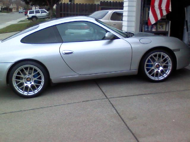

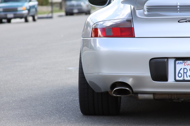

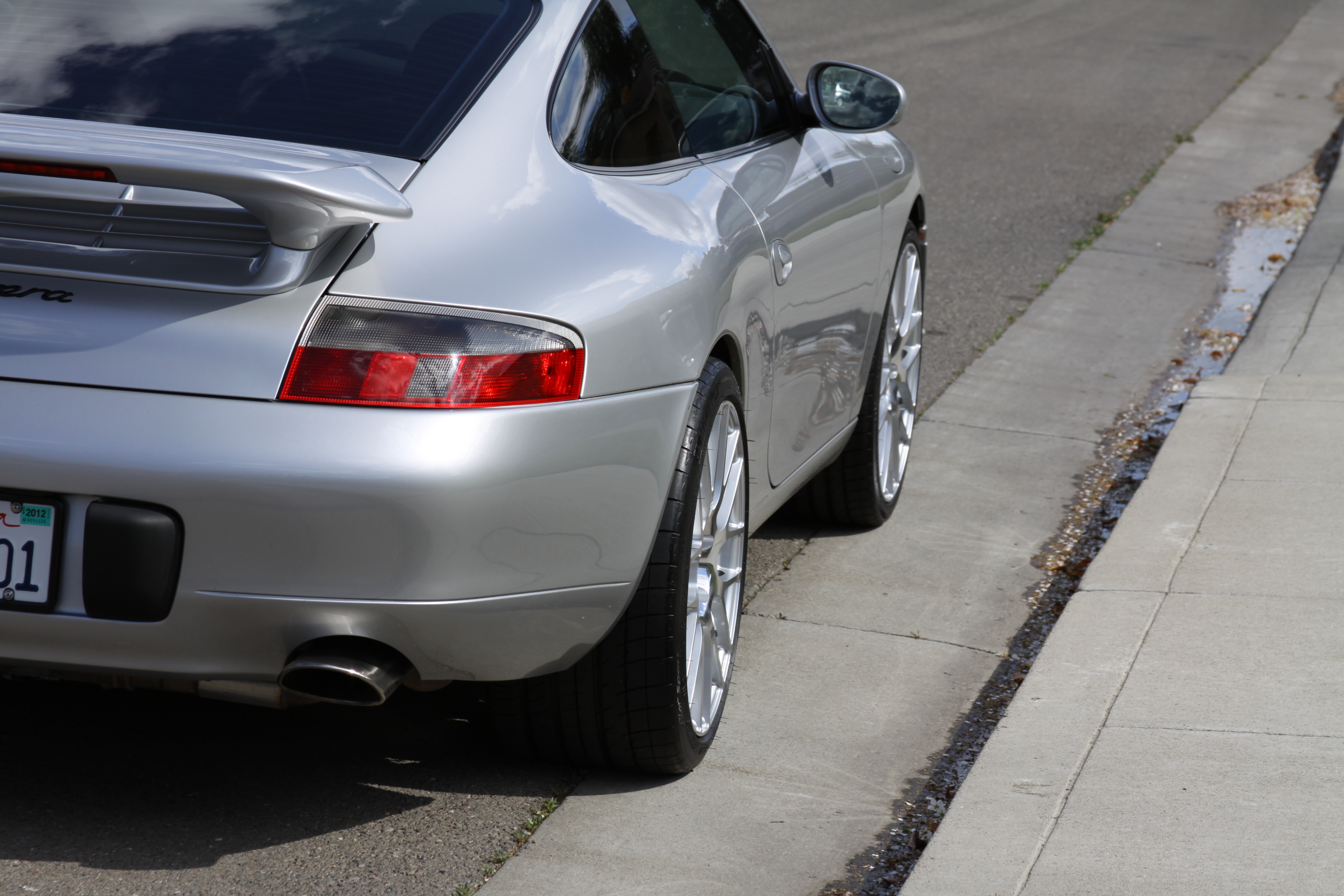

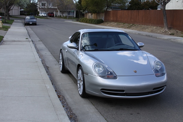

Stock suspension.

ok yea i also have stock suspension but my rears stick out half an inch more... just enough to hit the fenders and rolling them will not help. If i add spacers that will make it worse and my off set are 52 for the Ruger Mesh.
Old Jan 3, 2014 | 02:09 PM
Pors-Vette's Avatar
Joined: Feb 2012
Posts: 322
Pors-Vette is a jewel in the roughPors-Vette is a jewel in the roughPors-Vette is a jewel in the rough
Yeah, rolling fenders isn't going to help you any. I would try to return the wheels and look for something that will fit with minimal adjustment.
I was told that once tires are installed on the wheels they won't be accepted for refund or replacement. Hopefully your dealer will honor a return/replacement since they told you they would fit.
An et of 60-65 on the rears should fit just fine with no rolling of the fenders. If you stick to a 19" wheel for the front you're going to have to roll them.
Good luck on whatever you decide.

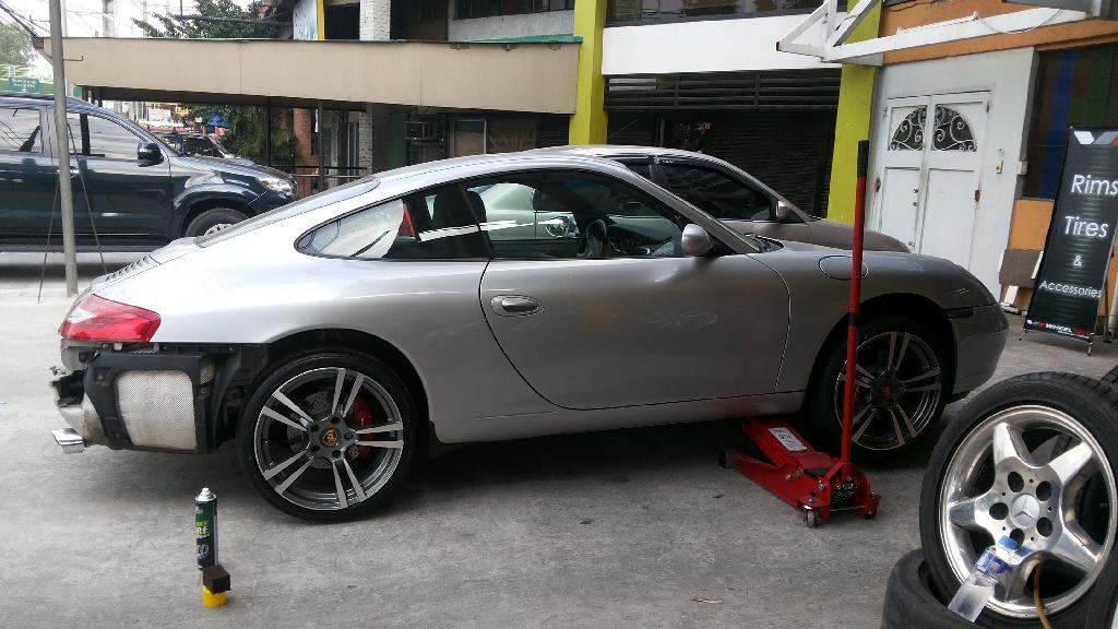

We seem to have the same or similar issues with our 19's. Maybe the only difference is that only the right tire is rubbing my fender liner that's why I was guessing that it's a camber issue (?) The left front tire is fine.
Here the front rim/tire specs...
Front rims 19" x 8.5"
tires 245 x 35
With 3mm spacer
@jacabean suggested to push the fender liner in and slightly bending the metal bracket at the back. I will do this within the week and let you guys know what happens.
Just sharing what my rubbing issue look like. Is this this same as yours?
This is how the car and rims look like...
