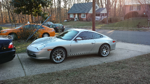

This is how it looks on the car as of now. The rears do stick out half an inch is that going to be an issue.

You really need to find out the offsets of the wheels first. The wheels and tires that you're using are larger (and wider) than the Porsche recommendations. I'm not saying that it's impossible to eliminate the rubbing issue, but I don't know that. You may be able to correct it with spacers or a different tire size. Are you running a stock suspension?

spacers will make them stick out even more than it already is from the look at the pics.or my eyes are playing tricks on me...you probably need smaller size tires...like others said, check the offset...maybe it's made for widebody like the C4S or turbo

The widest tire that Porsche recommends for the front of the 996 is 225, on an 8" width wheel. The recommended offset up front is 50mm. They don't recommend a 19" diameter wheel at all, so I don't know what to tell you on tire profile.
A 5 mm spacer in the front may solve your issue. A smaller tire may solve your issue.

The lowest size these rims come in are 19X8.5 front so the 225 wont even fit on the rim. I could put a spacer on but that might make the tire push out and might risk the fender to rub on the tire. That will also require me to roll the fender for the front. Im still debating if i should keep these or get rid of them. I just bought them a week ago.

they make these in 18" now . would be a better fit . if you lower the car it would look a lot better .

A 285 rear tire would be a better choice . if only the fronts are rubbing the fender liners you can push the liner brackets in a little for some clearance . this worked for my boxster .
