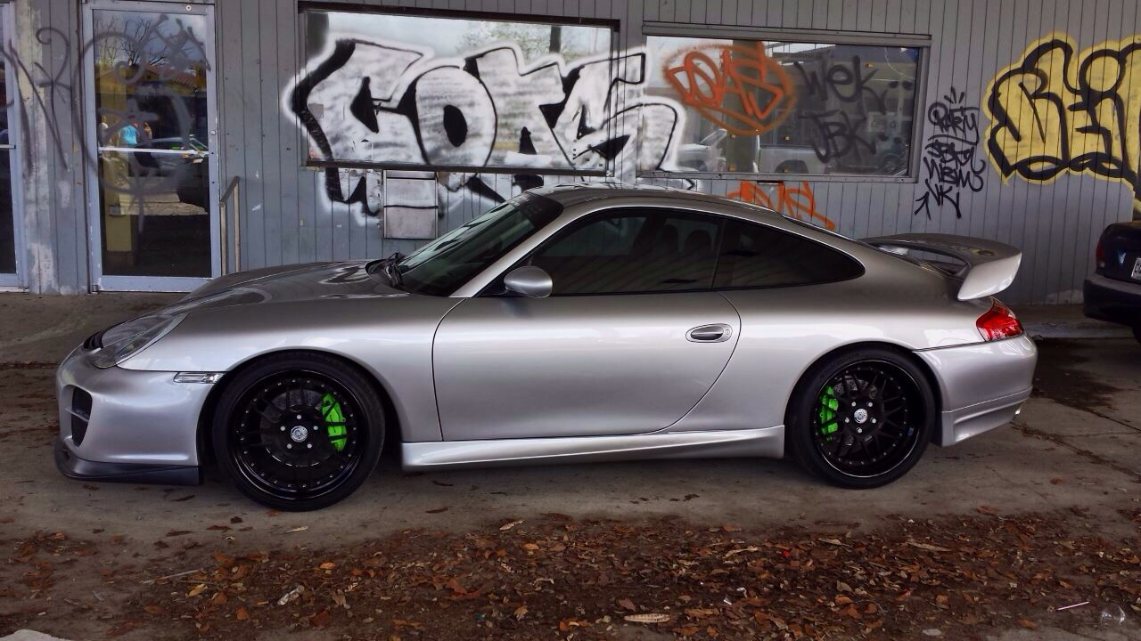

New caliper job

Are they new calipers or just painted a defferent color?

Originally Posted by juanchi300
New caliper job
Looks great Is that the same color as the Hybrid calipers then?

Details on which paint and if you did rebuild etc?

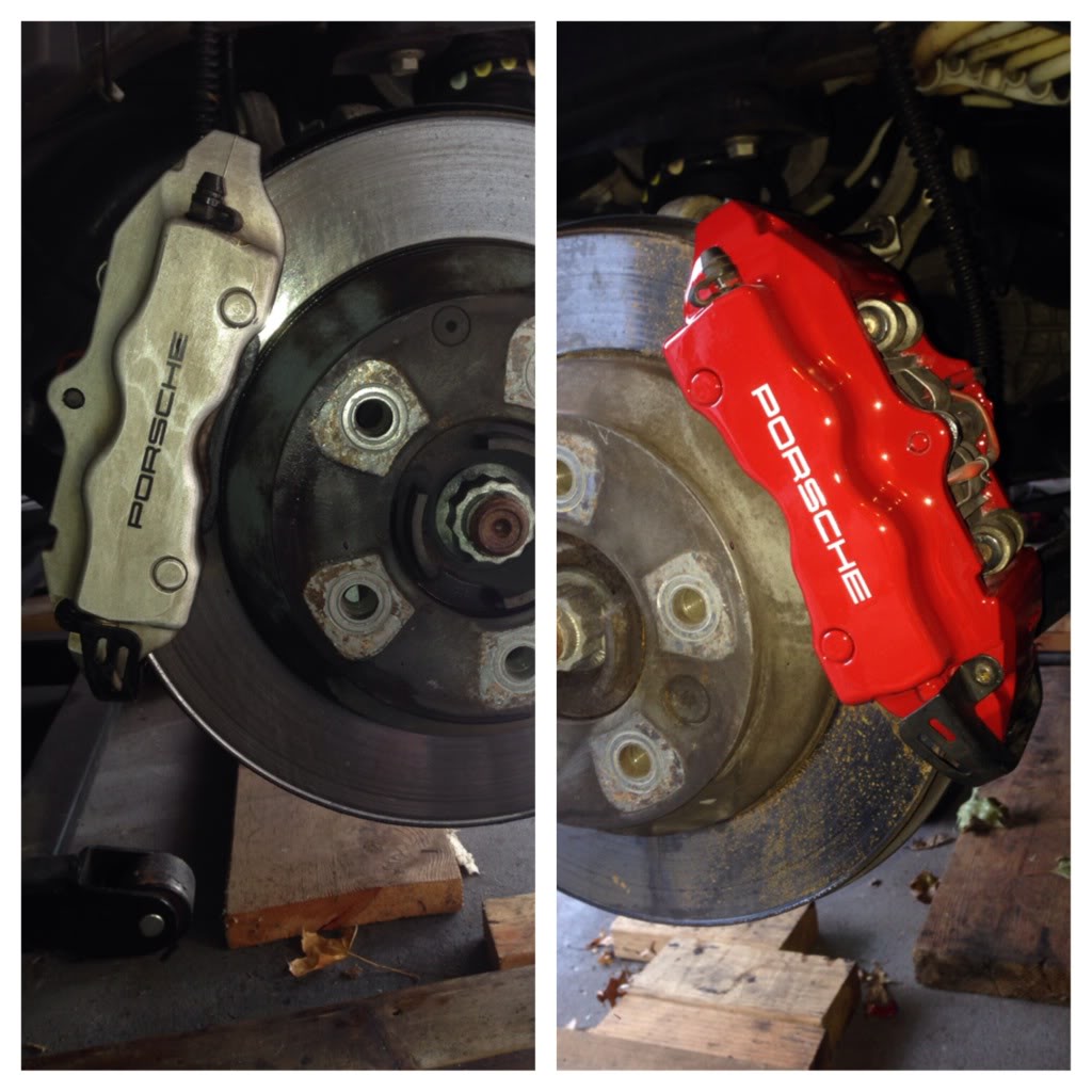

Great job! I did the calipers on my Cayenne last summer. Used Duplicolor Engine Enamel Primer,Paint,and Clear. Came out looking factory.

Sorry by the delay, the calipers are the oem , with mustang 2013 green color painted
Clear coated , remember to buy new porsche decals. Is an easy job , just remove the calipers ( put a hose with a bolt in the other end on lines to keep the fluid) washed with degreaser, and take it to body shop. I pay $85.00 , they just sanded and painted,
P.d the body shop put tape at the pistons to avoid any paint.
