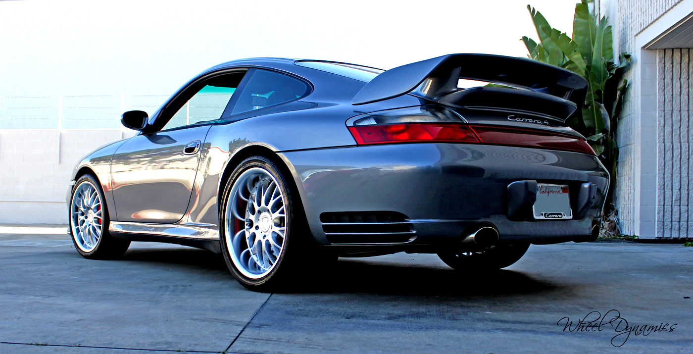

I had the same issue when I bought two front new tires. This exact thing happened to me after buying new tires. I was told the PSM was engaging which only happened on off ramps. Not really pushing it at all. I turned off the PSM for about a month and no issues. After a month I turned the PSM on and it never has happened since. I recently got new shoes and tires for my ride (19) and everything is perfect. Rusnak said when you switch out just 2 tires this might happen with the 4S. Hope that helps.
