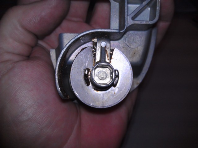

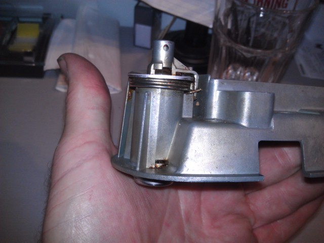

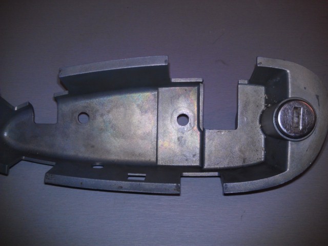

The car is a 99 996. My key is spinning in the cylinder. I have disassembled it and have learned that the cylinder is to moving the tail piece behind the rod that connects the cylinder to the actual lock mech. I can find the door handles on line easily enough but for the life of me I cannot figure out how to get my lock cylinder out of the existing chassey in order to put it into a new one. I talked to my local stealership and they said they could order me a new one from the fatherland for a paultry $400. He said that I would need to provide my VIN so that they could make it for my car! I've looked and looked for any previous talk on removing the cylinder with no success. Is it perhaps not removable? If not then what are others doing when they buy the ones for sale off of ebay? Any suggestions? Thanks.

Originally Posted by adrce55
Same thing happened to me.
Basically you push down that shaft part and there will be groove to allow you slide off the washer part off.
Once you take it all apart, most likely the rotating sleeve will have broken pins/fingers.
I bought a door handle from ebay for 50$ bucks and scavenged the part from it. You keep your original key barrel.
Pretty simple fix...
All of you guys are awesome for taking time to give me your input! It became clear that the washer was not removable on my particular assembly because the internal cam that had busted had moved itself around in a way that it prohibited the compression of the unit. I put it in a vice and with about 30 pounds of force, it gave in. I was able to find a complete assembly locally for $40. I only needed the cam inside which was probably about 50 cents worth of pot metal but what the heck. I will say this, it appears that the lock cylinder cannot be removed from the assembly without the original key. So in other words, if you find an assembly, you will need your original assembly to piece it all back together since you will not have the key to the replacement assembly. Also, I took the opportunity to clean all of the parts completely and grease them with lithium grease. Alan
