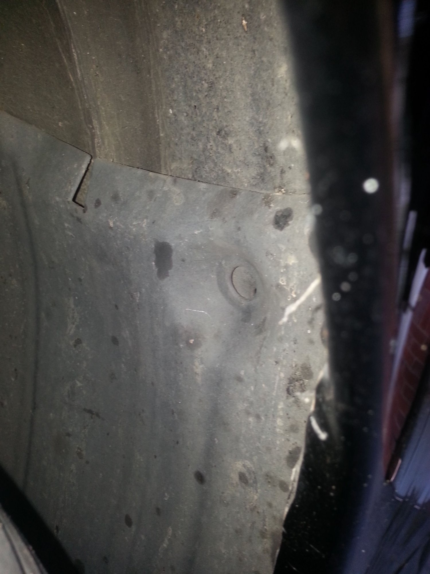

Got a IMS bearing and a new clutch done by a specialist, long story short they scratched my side skirt which they offered to fix.
They picked up and dropped my car off but it came home missing one of the inner wheel well screws (and the thread is also gone). Which they re attached with simply putting a screw through the lining... grrrr My question is can this thread be replaced?
Also they have managed to twist my dimmer/trip reset **** on my instrument cluster. How can I straighten it?
Thanks
How can I replace the thread that goes through that hole?
