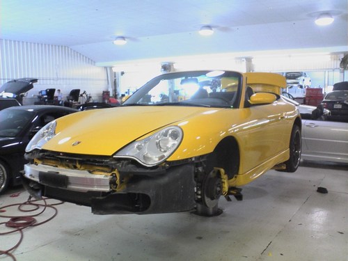

Full Frontal Nudity (Not Work Safe)
Look away if your easily offended

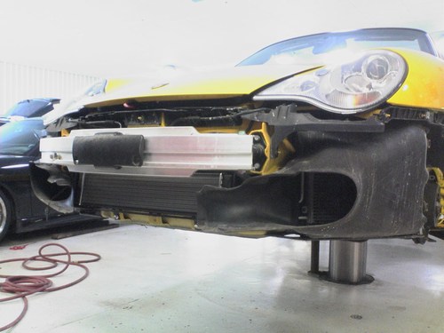

another...

here's one for all you "butt" guys

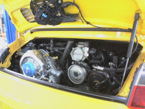

Check the SC oil drain line
Deputy see if you can have a hard line made for the SC drain line back to crank, there's not much clearance there between the belt. May say you some trouble down the line. Just a suggestion.

they already did a redesign on the oil return line. i did not see the old one, but the current one appears to be very stiff and has about 3/4" clearance between the belt and the line. if they anlged the engine fitting a little more coming out of the motor, it would be even better, but there may be flow issues with a 90 degree bend. the fitting is at about a 45 degree bend now and looks like it shouldn't ever touch (knock on wood).
on the name note, they are also releasing silicone boost hoses to remedy some old issues as well. i should hopefully get one of the first production sets.
