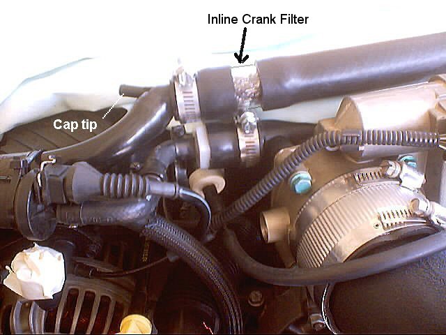

DIY Crank Filter

Karlooz if you are getting excess build up of crank oil in the intake I have installed a DIY in-line course filter that can be periodically cleaned it will keep your IC cleaner also. You can see instructions if you wish here.
http://www.webbspot.com/porsche/html/crank_vent.html
THANKS A BUNCH!!! i was going to rig something up but this is perfect. on thing.... most of the pictures from that link are for a transmission DIY

Ok try again
Thanks for the heads up on the pictures, I do not know why this is happening but I will republish the pages, and let me know what the results are thanks.
