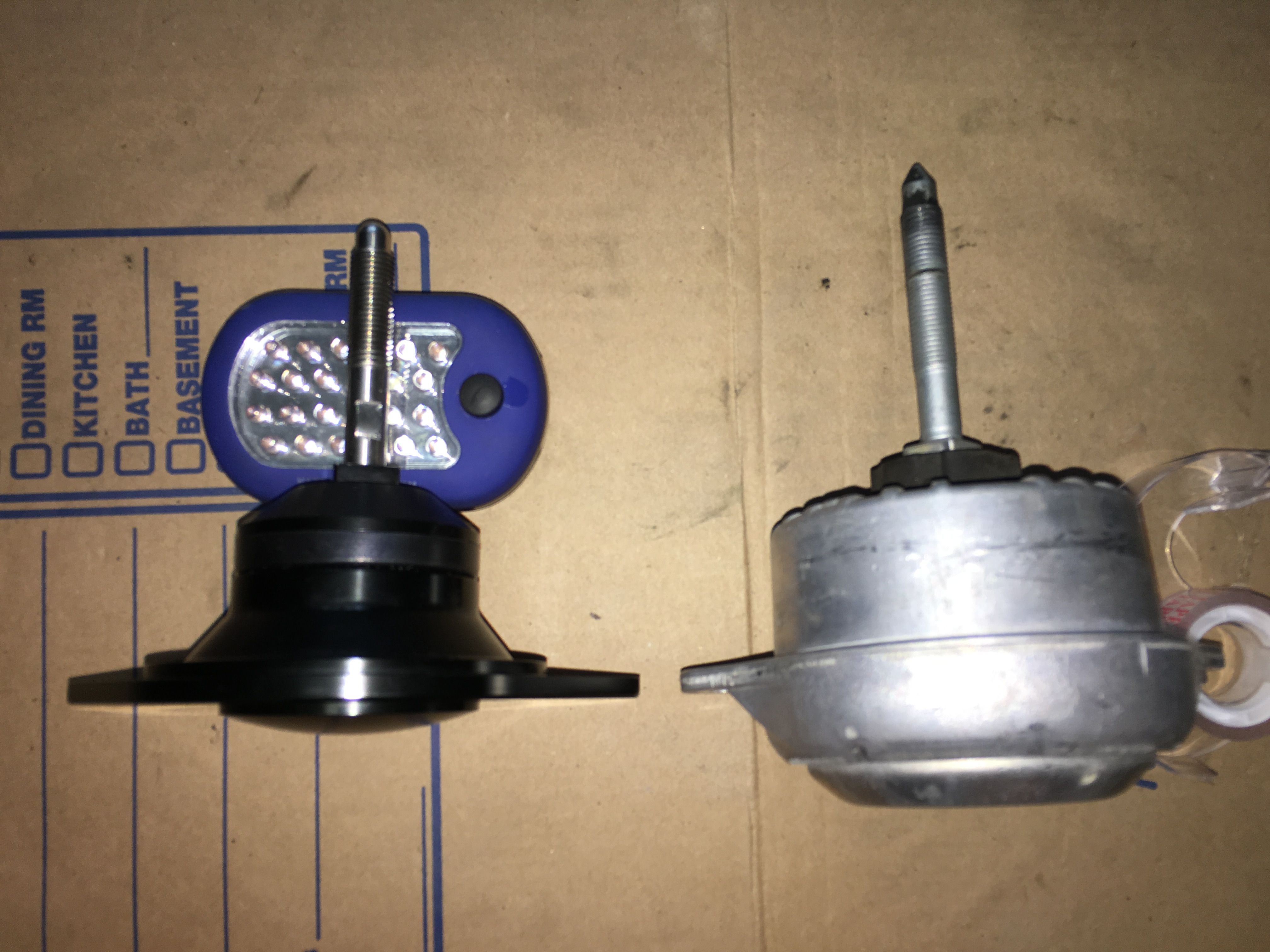

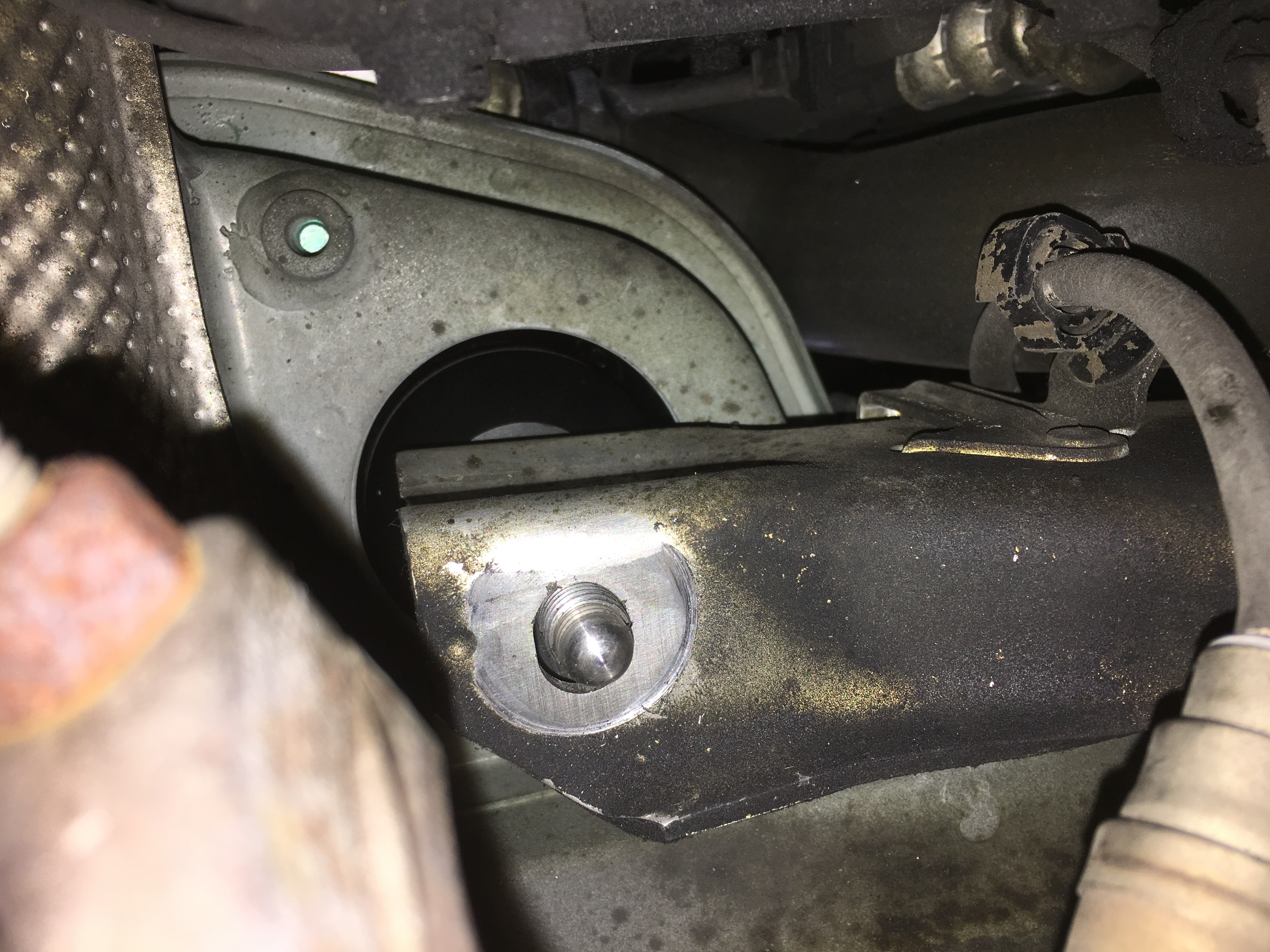

After removing the stock right mount, I attempted to install the new mount, but it doesn't look like there is enough thread on the bottom to screw on the 18mm nut. Looking at the stock and torquesolution mounts side-by-side, I see that the torquesolution's thread is about 1cm shorter. I'm posting a few pictures in case these helps.
Did I purchase the wrong part? Does anyone have experience installing these mounts on their 996 car?

that doesn't look fully seated. The square where the rod meets the mount has to drop into the "housing" on the car....you'll have to turn the "square" portion a little

You're right, the new mount sits about 2mm above the body and freely rotates, indicating that the square part is not mated with the square hole in the body. I believe the tapered part on the bottom of the new mount is preventing the mount from dropping all the way in place. I didn't try to force it in since I didn't want to cause any damage to the new mount. I was wondering if someone went through this once and can help me figure out if I should force it in.

I had the TS but it's been a couple years since I've removed it....IIRC I don't think the tapered part had anything to do with fitment. I had to have the square part aligned the same way as stock mount then raised the engine up....fit right in

If you look at your posted picture of the 2 mount, the right/OEM mount has a rubber square part. Right above it in your picture, there is a metal square part. That metal square part that goes into the body. If you look at the TS mount, the equivalent square part goes into the body. That square has to be aligned same position as OEM

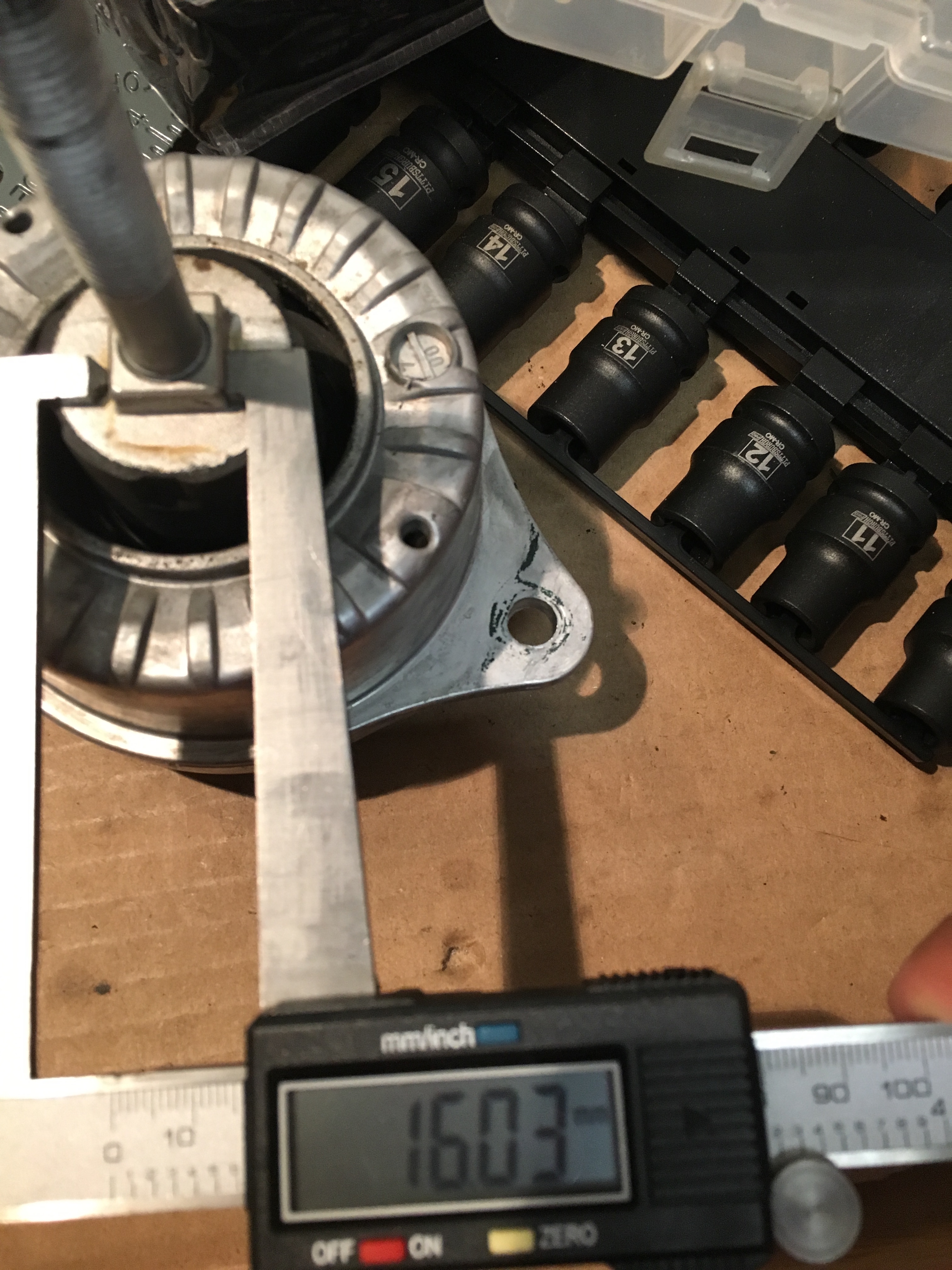

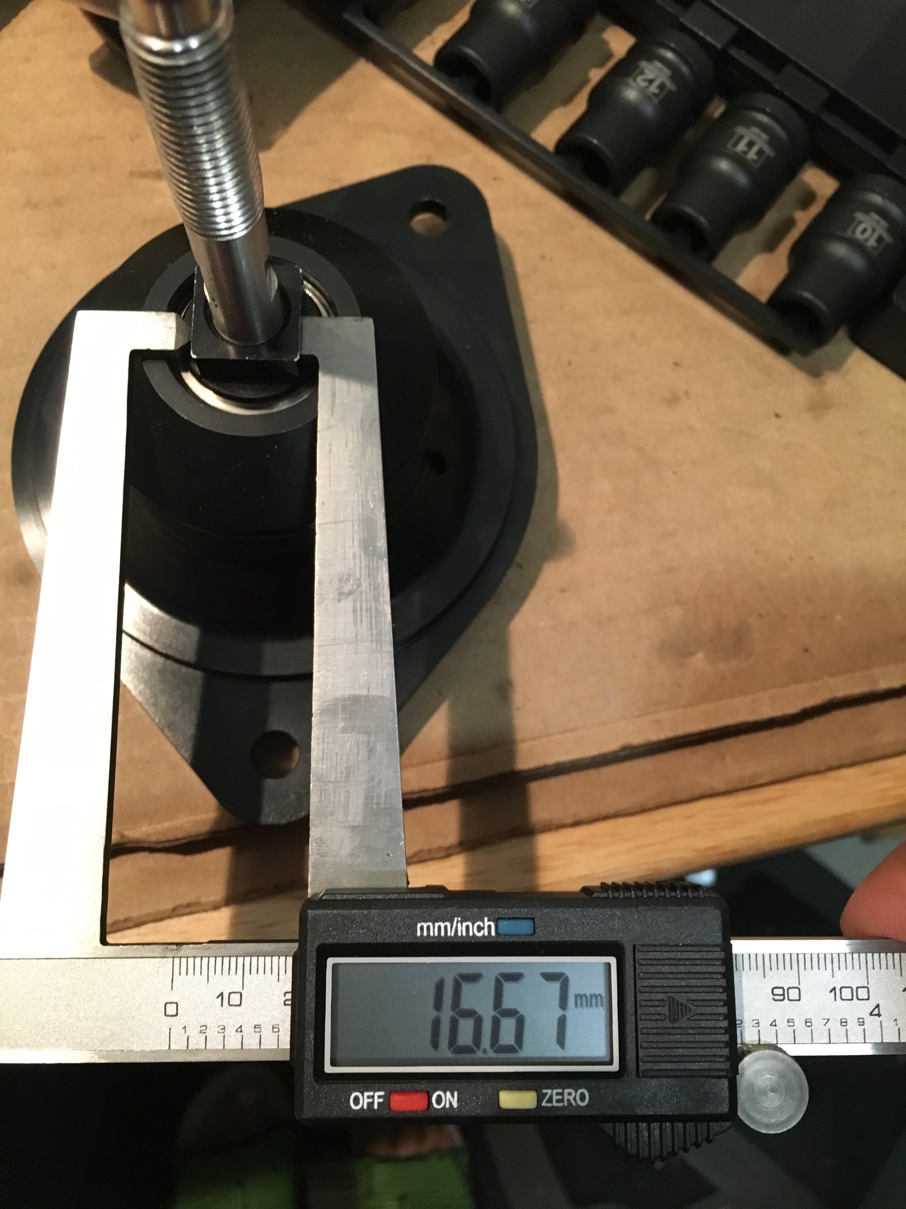

I think I figured out my problem. It appears that the square part on the new TS mount is slightly larger than the square hole that it fits in. It almost fits, but not quite. I compared the square part on the stock mount vs. the TS mount and found that the TS mount is about is 0.6mm larger (photos below).
At this point, my options are to (1) return the mounts, (2) grind the hole to make it slightly larger, or (3) grinding the square part to make it smaller. I'm leaning towards option 2.
-- Sam

You have documented it with pics so personally I would show TS the issue. It could be just a bad batch and see what they can do first. I would do option two as a last resort in case any future owners wants to put back in the factory mounts. Whatever you decide to do, good luck.

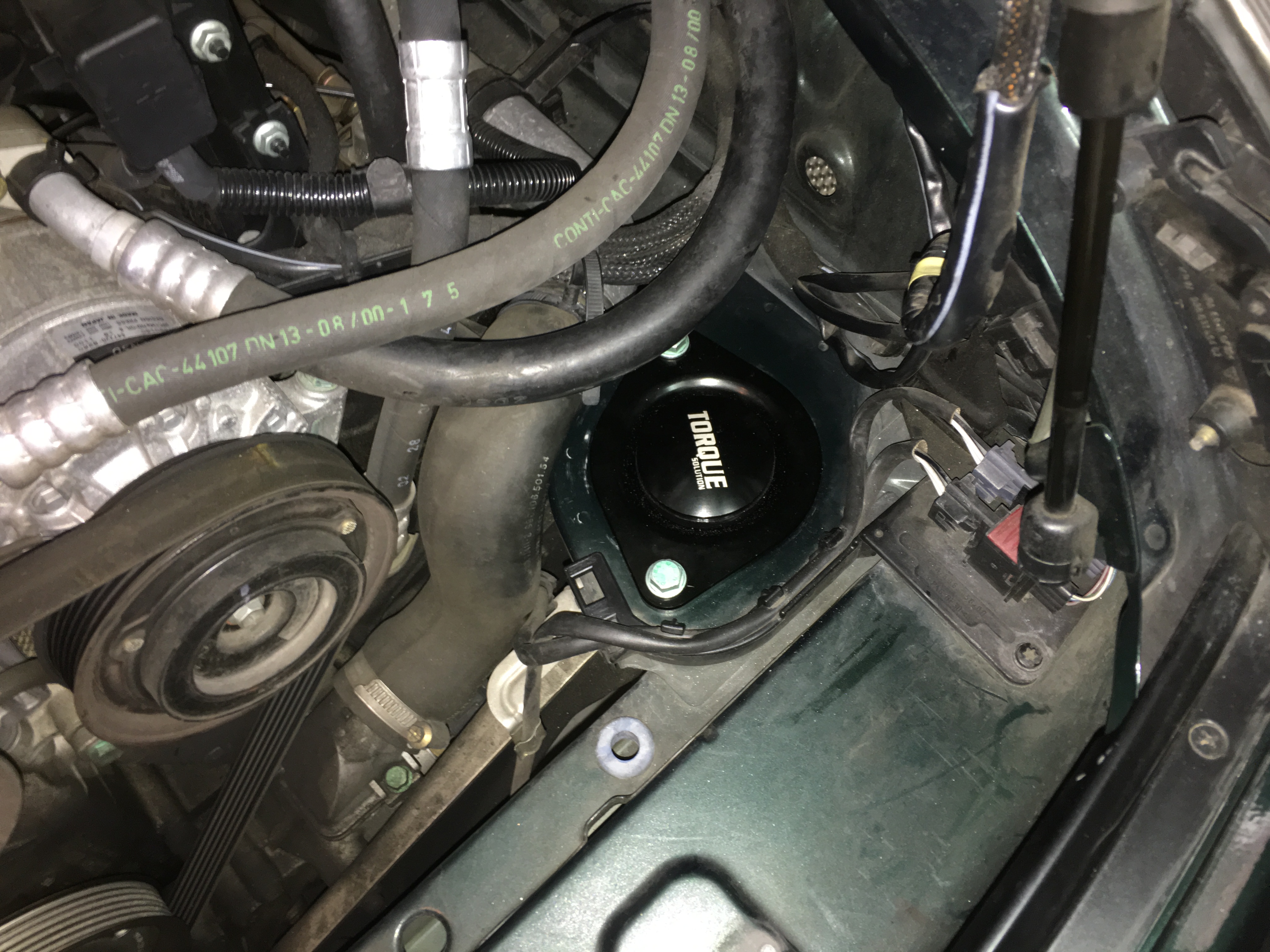

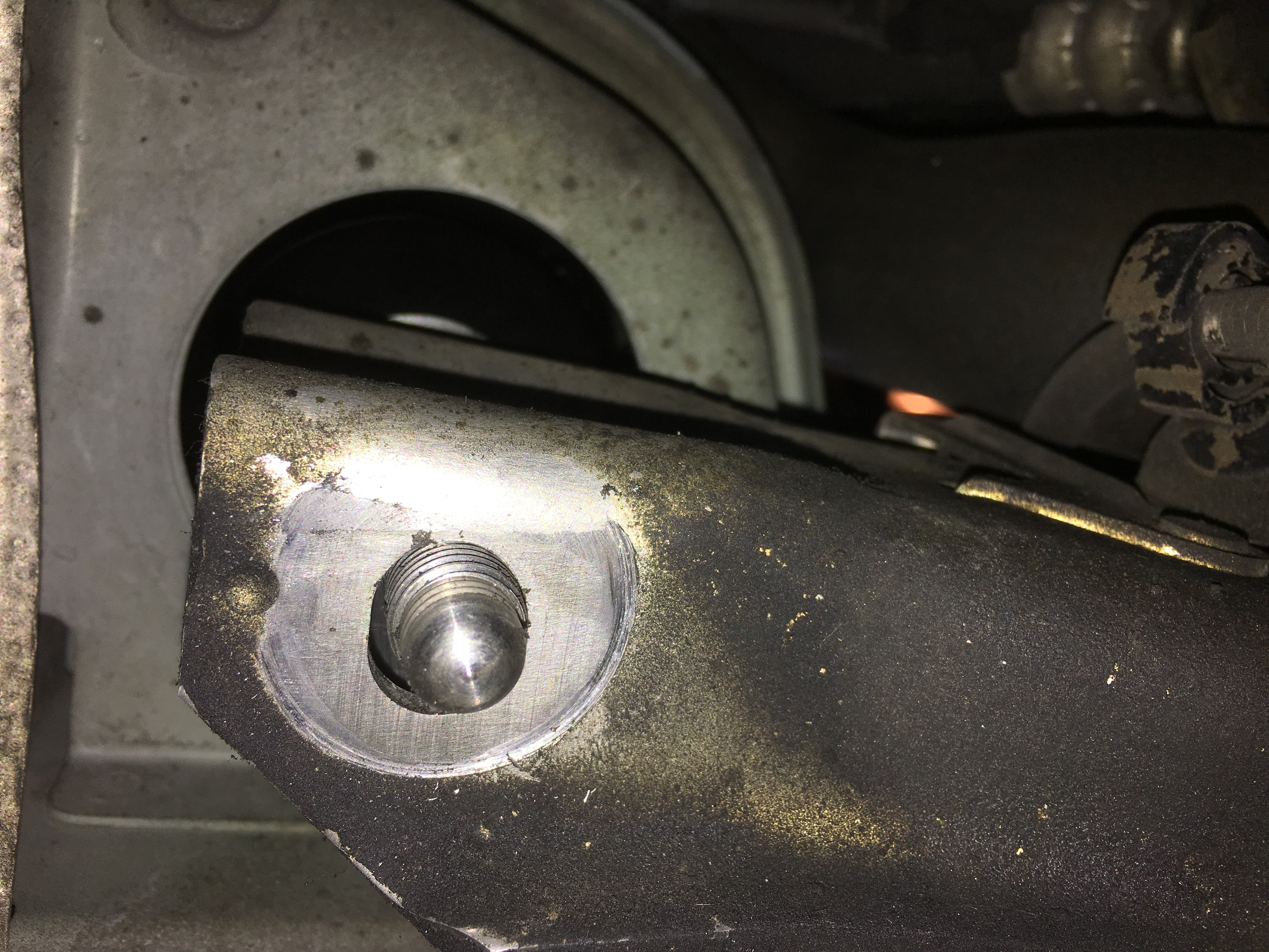

Thanks alpine003! I decided to go with a combination of options #2 and #3 and was able to get both mounts in place once a little machining was done to both, the square holes as well as each each TS engine mount. I just have to torque everything and to put everything back together, then I'll take it out for a test drive. Looking forward to a more solid ride feel and smoother shifting. Thanks everyone!
