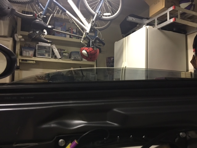

Help: I replaced my window regulator this past weekend and now I have two issues: First is the air bag warning light goes on. Second the window won't completely go all the way down. I reconnected the air bag so I know the connection is secure. My goof may have been when I reconnected the battery to raise the window to reprogram the program I didn't reconnect the air bag at the time. (Ugh) Second when I inserted the window back in to the new regulator it did go completely down, but now it is like 1/4 still showing See pictures. Thanks for any help anyone can offer.

winner winner chicken dinner. if you turn the car on with an airbag unplugged itll throw the light. you have to have a piwis/durametric/etc to clear it, or you can take somewhere that specializes in euro cars and they can clear it. I dont have any insight into your regulator not going down all the way, did you remove the spacers from the bottom of the regulator. They have to be removed in used in a 996 and left if in a boxster.

Had no idea on the removal of spacers on the regulator! Thanks for that heads up! Second I do have an OB diagnostic computer which I'll give it a shot today. Thanks again for taking the time to post. Really appreciate it.
This might sound like a stupid question but exactly where are the spacers located for removal? Thanks.. Would the spacer be seen here?

FYI: To adjust the window height is done by removing the outer plugs under the door using an E6 Torx socket to turn the stopper counterclockwise to higher window, and I assume Clockwise to lower window. Wish me luck. Found a write up on Pelicanparts.com

RngTrtl is right you have to take it someplace to have the fault code cleared. I took mine when I got an oil change other wise they try to charge you for it which is total bull cause all they do is plug in a computer and navigate to the setting that turns is off. As far as lowering your window be careful not to lower it to much. As a matter of fact I think that is the actual height of it when its lowered. If you lower it to be totally down when you roll it back up it might not make a strong seal. I would do a seal check at the top before you start lowering it. On mine sock height is a little out of the door.

I'll go and check it out. Thanks for the heads up!! I've noticed my window itself needs to be shifted forward a little. (I can tell from my tint job) Hopefully this will rectify the issue with the window not going completely down. Once I fix this issue, then it's dealing with the air bag issue and getting a shop to hook it up and run the diagnostics on it.
