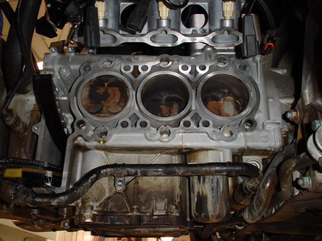

Same problem
Hey guys, sadly I had the same problem with my 2001 C4. Porsche did some tests and they said there was coolant/moisture in cylinder 1 and possibly 5. There is not any oil in the coolant, but I think there might be coolant in the oil. They started estimating me engines but it is way out of my budget. Does anyone know what this problem could be? cracked head? cracked cylinder sleeve? If I know what the exact problem is I will know where to start. Thanks.

msalamza is infamous around these parts
I have an update on my 2001 911 carrera. It has a crack in the cylinder wall. Does anyone know what the fix is for this problem? Any advice would be great! thanks.
