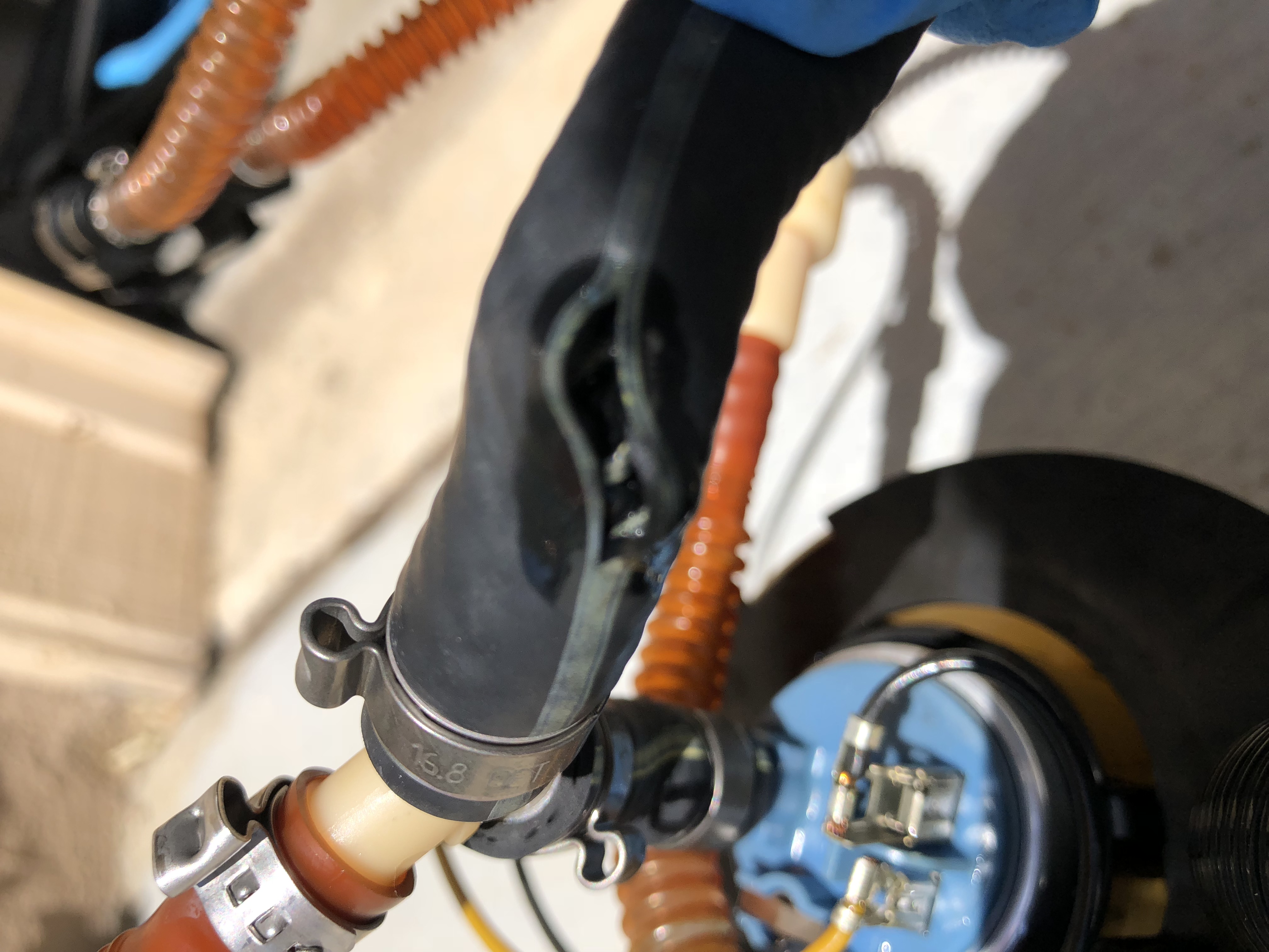

OK. Got the pump out, tried to squeeze the saddle hard line mounts, but the tabs push outward. I found this split hose, which I can see (barely) in the original photo of the top of the fuel pump. I think I read somewhere where a guy had his split and that was the issue of not starting. I do not want to get too excited, but it would be better a split hose than a fuel pump. I can try to install a replacement section of hose. What you think about that?

OK, I went to Autozone and spent $5 on a hose and clamps. Kind of a pain, but got it all back in there. I'm not certain I missed all the fuel lines with the sender. Anyway, I cranked it over and for about 6 seconds. Started. Drove it to the Chevron and put in 7.3 gallons of Super Unleaded. Lets see if it holds up, gonna have to take it out for a test run.

I think you found the source of your problem... replace that hose and I’m pretty sure your problem will be solved. Congrats!!!

I think this is the article that I read before. I hope this will help people who had a similar issue that I did; car acts as if its fuel starved, no codes, no prior issues. Maybe the GT cars have the pump under the battery, but I do not think the rest of our cars do. Looking at the initial photo, the offending fuel hose could be inspected (if you look in my photo, you can see the split) without having the pump removed from the tank. This inspection is much easier than trouble shooting items under the car on in the engine compartment- IMHO.

Cool deal! Did you replace it with an OEM hose or one of those fuel resistant flex hoses?

I used an aftermarket hose, I am going to try to find the factory one as it is shorter and creates more room for the sender. My new line as about 10" long. If you know of an OEM part number, let me know. So far all I have found is the complete pump online.
