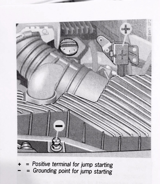

How do I pop the hood open to access the battery in a 2001 911 with a dead battery, the fuse box jump doesn't do anything, and there are no release wires found to pull in the wheel wells?

Are you able to pop the engine lid? I can on my 2000, not sure about 2001. If so, put jumper cables on the jump terminals. If not, there are release cables hidden in the front and rear bumpers.

For model year 2000, the latches are cable operated but the front latch has an electric lock. The engine compartment lid does not require a battery to unlock. I'm not sure if MY 2001 is the same. It should tell you in the owners manual.

Mine is a 99 1st gen. The rear engine latch opened even with the battery 100% dead. I was able to connect another 12v battery to the terminals pictured in wyovino's post and was able to start the engine and ultimately open the front trunk.
Take note that when you power up the car for the very first time, the central locking system will not disengage yet. You have to unlock the central locking system by pushing the unlock button on the dash. After that, you'll be able to pop the FRUNK open and get to your dead battery.
Be sure to immediately disconnect the 2nd battery after you've successfully started your engine. hope that helps.
