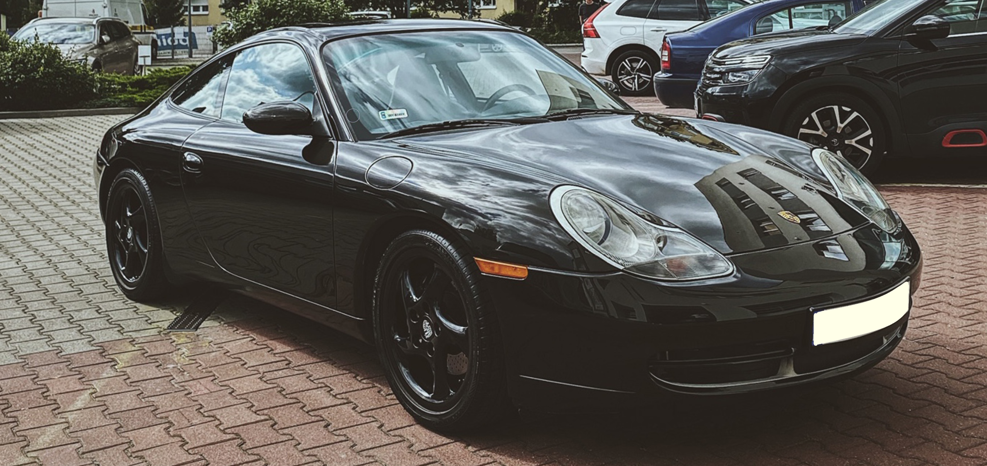

Hi everybody, last week I decided that the 997 needs an older brother. So, I bought a 996 C2 Manual with the cool cable throttle, I would also like to mention that it is a beautiful spec, incl. M030, sport suspension and seats, LSD, 996 turbo wheels etc. So, I am excited to say the least. BUT. I noticed a throttle hesitation issue.
When I say accelerate by pressing the pedal up to 80% all is fine. But quite frequently when I give it the full beans it stutters and hesitates. At 4,000 RPM and above. As an example, when I accelerate on 2nd gear up to 7,000 RPM at 50% percent and then shift to third and press the accelerator to 100% it jolts and stutters and I feel as if not only I pressed the throttle at 80% but rather 40%. It seems like a fuel delivery issue. Would anybody know how to solve this or where it is coming from?
