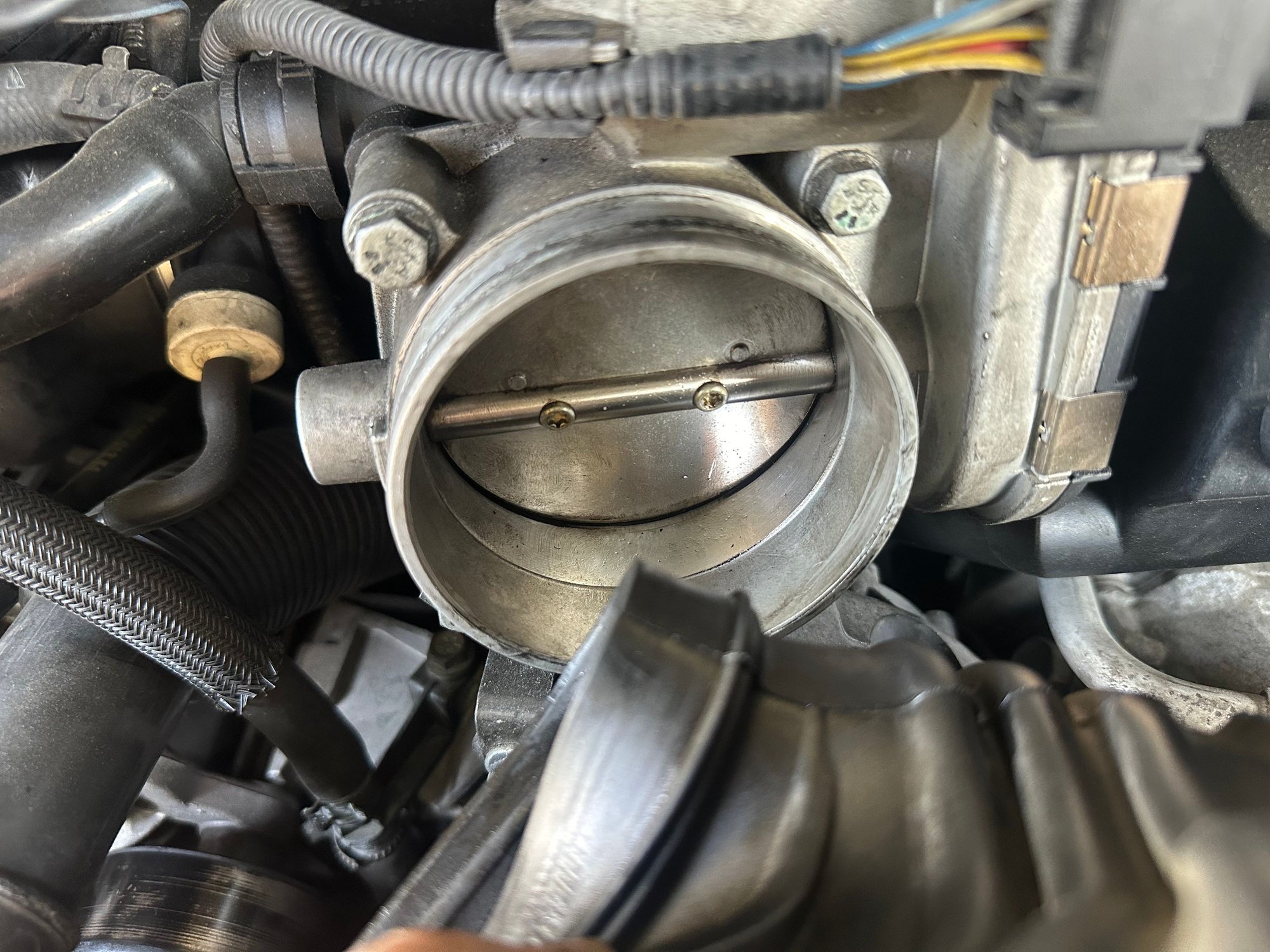

My 996 randomly started idling weird today, with it being 1k+ sometimes, then a minultr later down at 500. Assume a vacuum leak, but checked throttle body and is also has a slight opening, is this normal or do I need a new throttle body?
Photo attached

Solved
Fixed, had loose oil cap
