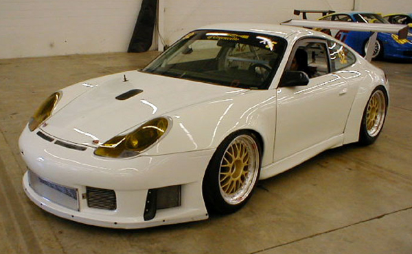

one thought... you have the RSR bodywork. unless you have the proper front ducting, the air drawn into the front bumper intake openings can go out towards the side of the bumper. the airflow can further be forced out the sides if your radiators are in the stock location, they can deflect the airflow out to the sides. either relocate the radiators to the RSR locations or get some ducts and close up that side opening.
check out the pic i attached. you can see the radiator is turned. the RSR ducts re direct it almost 90 degrees and out the side. the oem way is out the bottom.

thanks Carlos... mine are already set like that.. I think my BIG problem is that I did not burp it properly!! I will take care of that over the weekend! right after I install my new brakes! thanks guys!

really? my memory must be going. i thought they were still in the oem configuration.
kewl... but... it's great they went to the trouble to reconfigure the radiators but funny that they did not add the middle 3rd radiator

ya now that you point out to me about all the changing they did.. i am surprised they did not add it myself...
you should see from the two pictures that I uploaded how they changed to position of the radiator. I didn't even know they were different on stock cars
