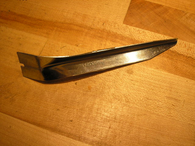

Alright I read the directions on how to switch out the faces. Fantastic directions however it states that the kit should come with a needle puller. Mine didn't anyone know how to get it out without one? Dont want to break it!

I would attempt to make one. Some sheet metal and tin snips would do the trick.

Any idea what it looks like so i can make it. I feel like McGyver!!

PM me your address I will send you mine all that I ask is that you send it back.

Sure is it something easily I can make? If not yea please send it to me and I will mail it back to you.

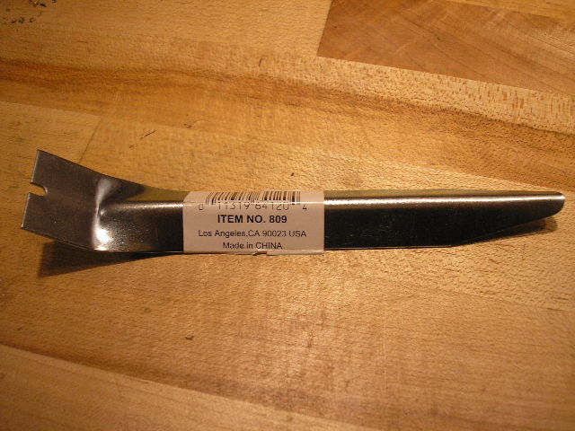

It looks like this....

I got it off a fork works....Thanks again for the pictures they really helped.
