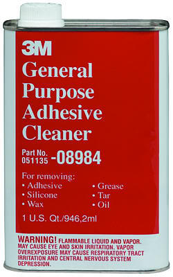

This stuff won't harm your paint, plastic, vinyl or rubber.
3M General Purpose Adhesive Remover
Follow the instructions and don't rub the paint, just let if soak and then wipe off. If you go to a bodyshop that's what they'll use in the back and charge you $100. You can get it at CarQuest
