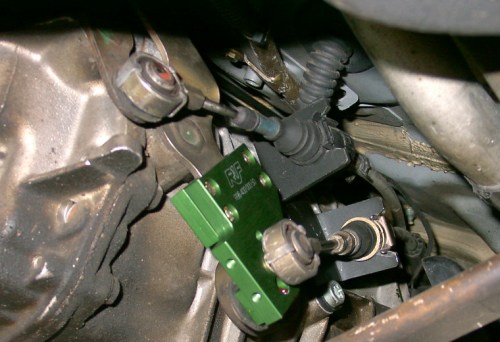

I had the B&M under car kit installed a month ago and really like it a lot. Shift throw reduced 30%, and much more defined. I was concerned, based on posts I've seen on various boards, that the in car kit would increased shifting effort too much. Mine is a daily driver, so I didn't want the shifting to be overly tight. Here's my post with more details:

Originally posted by msindi
FYI - the RUF, Techart and B&M under car are all the same except for the price tag!! the first two go for upwards of $500 while the B&M can be had from Brandywine (have not found anyone else who sells it yet) for about $200
Yep--from looking at pix of the RUF and Techart, it appears the only real difference vs. the B&M is the color--and the price! The Techart goes for $750, and the RUF was quoted at $400 from one source and $500 from another. I got the B&M for $175 from Brandywine.
Here's a pic of the B&M (blue) installed on my car, and the RUF (green):
